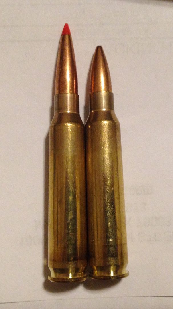

Blehh, my A-Max load isn't working out I don't think.
None of my manuals have a load for this bullet, so I went with a 175 gr load and went way lower than max powder charge for the 178 gr A-Max, but it wasn't fitting in the mag because of the plastic tip.
So I kept adjusting my Dillon bullet seating die until it cleared the mag (it's still near touching the inside of the mag), but it put a good ring on the bullet.
It makes me think the bullet is too long for this powder charge and the seating die might have put too much pressure on the bullet.

Here's the problem... as you increase your seating depth, pressure can increase dramatically. You need to be careful! Watch for pressure signs (primer flattening and ejector swipes). I have loaded AMAX in 223. The ones I own cannot be loaded to AR mag length. Hornady should have load data on that bullet.
80 grain AMAX and 77 grain Sierra Matchking (mag length). If I loaded the AMAX to mag length, it could kaboom the gun.

Thanks for the info, Mike.
I pulled the bullet and trashed the load earlier.
I then drastically lowered the powder charge after some research.
I used 37 grains of IMR 8208 XBR. The powder is well below the neck. Not a compressed load and did not leave a ring on the bullet like my first try.
Next to a factory M80
Clears PMAG
