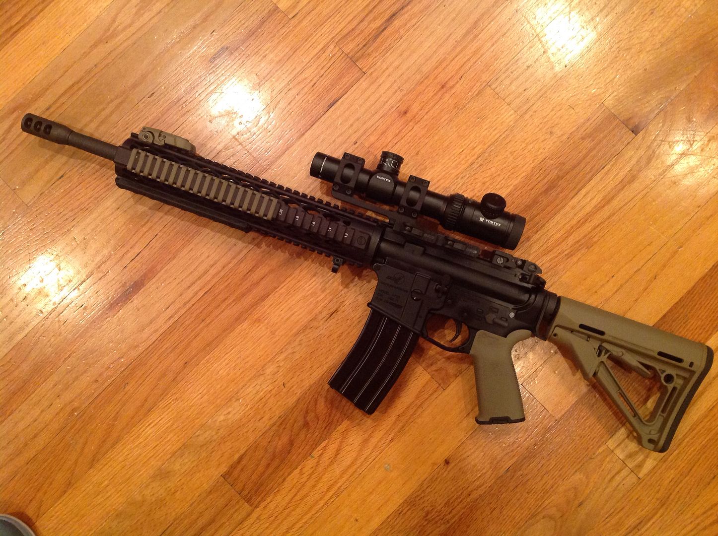

One of my ARs is experiencing problems while running a heavier full-auto BCG. However, it is flawless if I run it with a lighter BCG.
One issue is the brass not ejecting very far and at about 1:00 position. The other issue is the bolt not always locking back on empty mag. It seems to me that the FA BCG is too heavy for the gas system because the lighter SA BCG throws a neat little pile at 4:00 position and always locks open on empty mag. It is a 5.56 16" bbl, mid-lenth gas, carbine buffer.
Is this common for a ML gas system, or do I have a gas problem (lol)? Or should I try a lighter buffer, or maybe I should just get a SA BCG for it since it runs so well like that. Suggestions?
