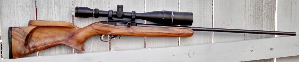

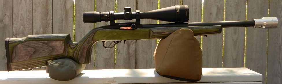

Here are some 10/22s I enjoy/enjoyed shooting:
There is a Feddersen barrel under this one somewhere:
I was going through a "phase"
http://s862.photobucket.com/user/graycrait/media/todays1022s_zps5fcc7881.jpg.html?sort=3&o=54
It never ends
http://s862.photobucket.com/user/graycrait/media/Mannlicher1022_zps48c8f6c2.jpg.html?sort=3&o=84
and on and on
http://s862.photobucket.com/user/graycrait/media/Last3rifles_zps6e841add.jpg.html?sort=3&o=102

I would say the best deal for the money would be a Boyd's pro varmint. That would be the green/black stock Graycrait posted above. One of my personal favorites is the Bell &Carlson Anschutz stock.
