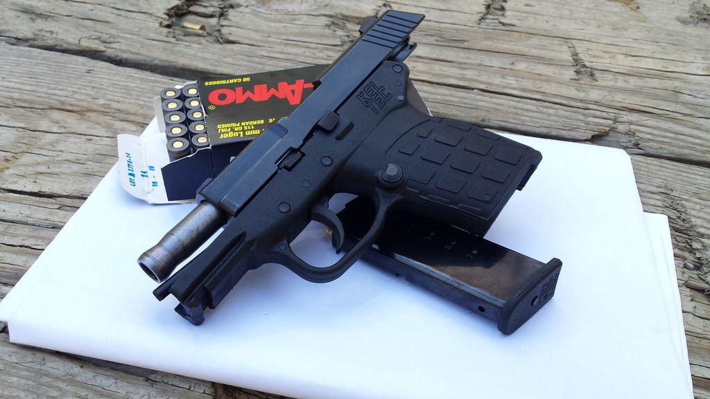

Picked up a little pocket 9 today. Stopped by my lgs looking for a summer carry pistol. Found this little PF-9. Not my first polymer pistol, but it is my smallest.
I came home and grabbed a bite to eat and field stripped it and loved it up with some ballistol. Grabbed a box of 50 and went to the range a few miles up the road.
I hate going to public ranges, to my surprise, not a soul in sight! Jackpot! So, I grabbed my box of ammo and went to shootin. Found some unused targets which was nice.
Initial impressions: the little gun ran like a champ. Granted, more shooting will be needed before shorts season fully arrives. Another thing that I noticed is that the slide lock is STIFF and I do mean stiff. It's slowly starting to loosen up. But, I can live with that. One last thing, make sure to move your fingers away from the magazine well. Magazines hurt when they pinch the skin. That's some free advice [emoji6]

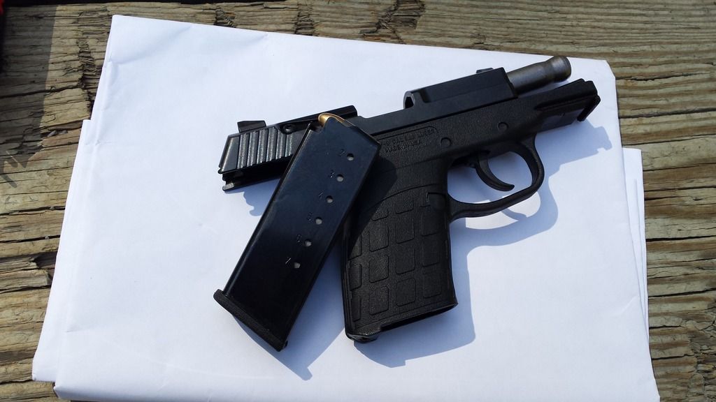

Well after a week and a day of ownership of my little pf9 it's going back to keltec. I am having extraction issues, ftf, fte, stovpiping a jams. I would guess that around 75% of the brass came back toward my face or arms. I even have hot brass down the a@@ which was not very pleasant! As soon as the shipping label is emailed to me off it will go.

Actually it might not be the guns fault. Thing's I noticed with the PF-9 I once owned were if I inadvertently applied pressure to the magazine baseplate it could adversely affect feed. The magazine release button was also easy to bump which would unseat the magazine enough to affect feed.
Mine had a distinct break in period where after running about 150 rounds through it things smoothed out but I still had to consciously focus on hand and grip placement. If you visit one of the K-T Forums you'll read about "fluff & buff's" but your pistol being newer shouldn't really need that.
One thing I learned with the K-T PF-9 was the Pierce base plate adapters and my hands weren't a good thing. Learning your gun is very important. Recognizing when there's a particular gun you can't make work for you is equally important. Its all about experience and experimentation. Best of luck to you.

I ran the gun pretty hard yesterday of various different types of ammo. Ran around 300 rounds. The gun hates jhp rounds. Will not feed them at all. When it did, instant stovepipe! I've been shooting guns for a long time, I've shot other keltecs before with no issues. I can handle a gun no issues. I did notice that my finger touched my mag release. I adjusted for that. But, I will not carry a gun that I don't trust! And now I've lost my trust in that gun. Hopefully, keltec can get it right. I hear good things about them and customer service. Maybe the little gun can earn my trust once it's all fixed.
Make sure the "frankenbolt" is tight.  It's the bolt that holds the extractor.  If it's loose, put a drop of blue loctite on it and snug it up.  That bolt being slightly loose can cause extraction problems.  You can also look at the rim on the spent brass.  If there are heavy scratches or gouge marks, that probably means the extractor is slipping off the rim as it's removing the brass from the chamber, hence the stovepipe.

The good thing about it. Keltec just sent me a shipping label that I'm fixing to print off. So, I'm going to let them have a look at it on their dime.
Looking at it and looking at that frankenbolt it looks and feels in good shape.
Something is making it kick straight back. Like I mentioned in a previous post above. Hot brass down the a@@! Woo-hoo that was a thrill lol. .
