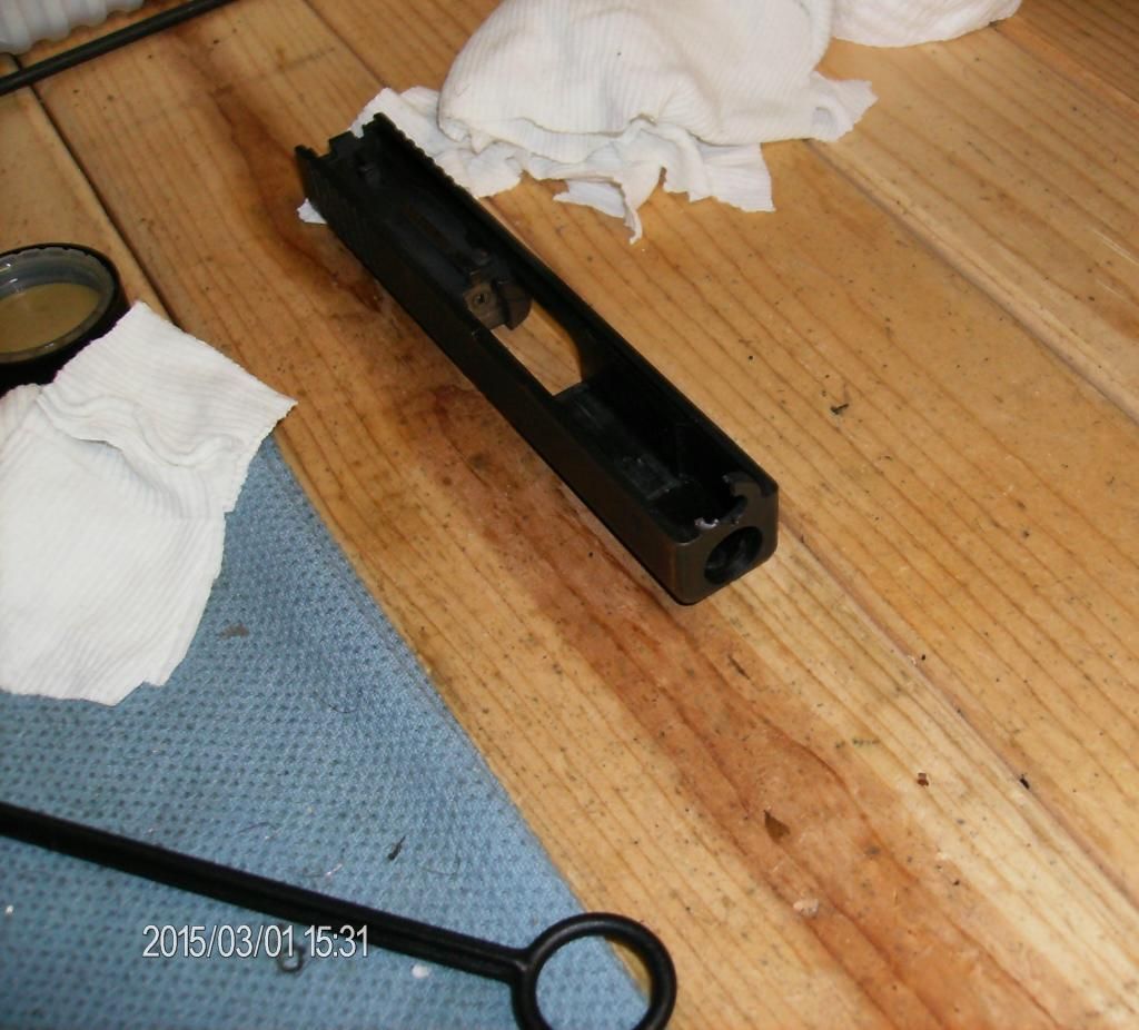

I was at the range doing some practice drills last Sunday. Completely uneventful range session. When I got home I actually decided to clean my Glock 19. Now that's not something I do after each range session.(I normally just run a bore snake through it) Yes, I can be abusive to my Glock. But having better than 30K of rounds through it, I've come to trust that little sucker.
I'll treat her better in the future.
Here's a few pics of what I found...

Well Heck! So now I know for certain that a Glock can be broken...you just have to shoot it enough!
Actually I thought it would take more rounds than that...
fwiw I do change my RSA every 1500-2000 rounds and keep my Glocks appropriately lubed.

I presume they'll just send you a new slide.
Wowzers. That's a new one for me! Wonder when that happened, and how many rounds it fired without a hitch in that condition. Cool that it stayed together. Looks like it still had about 70% coverage around the guide rod/spring.

I've not seen this particular issue with a Glock before. My guess is that there was a metallurgic defect in that portion of the slide. Realistically 30K isn't that much ammo to run through a handgun.

How often have you changed the recoil spring? It looks like maybe it had lost some of it's "oomph" and had been reaching the end of the spring a lot sooner and faster at each recoil making it hammer instead of a smooth ride back. Glad to hear Glock is making it good.
LOL. the "RSA" in my OP is "Recoil Spring Assembly"...sorry for being "murky"...I change it frequently and have several new ones waiting in my parts kit. :pleased:

I've seen it when an unassembled slide gets hit hard enough.
Yeah..I've seen them dropped and bend at that point when disassembled as well. Now this one has hit the deck many times in training, but always while it was fully assembled.

Well anything's possible but most of the breakages I've seen on Gaston's Tupperware have been polymer frame or internal parts related. I am certain you will receive a new replacement slide from Glock if not a replacement pistol because they're that kind of a quality first, customer service company.
My guess is that slide had a stress defect that finally let go on you. A full muzzle first drop assembled or disassembled could induce a stress fracture as well. Bottom line Kaka happens to any and all firearms or related gear but now you've got a cool "I broke a Glock" gun store/firing range story to tell.
