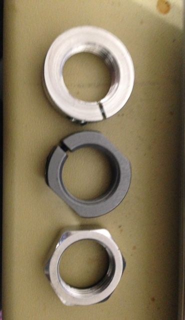

I was watching a video and he said he can still use the rings from RCBS, Lee and a few others. Even shows him using them on his coax press.
https://www.youtube.com/watch?feature=player_embedded&v=NEzVZe7f6G0
At 5:30 he talks about the rings.
They're not the same. I've heard that too. I don't agree.
I have rings that came with the Forster dies. Likely,some of the cross-bolt type rings will fit, but not sure if they will work as well.
Have to do some experimenting to see if they do. The die holder and the shell holder both have flexibility, so they self align both ways.
Some die rings have a set screw that fits against the die thread, and can sometimes set cocked to one side slightly. The press should compensate for that.
Regardless, I plan on using the Forster rings. May have to get more later for other dies.
Thanks for the input guys. Altogether new type press for me. Any hints are welcome. Pride is in the bottom drawer, LOL
Not a whole lot to know, other than what's in the book. Been there done that trying to use other die rings. The Forster rings just aren't that expensive. I did replace the screws in mine, and used a fat wrench to tighten them. Since they're aluminum, it's possible to strip them out.
