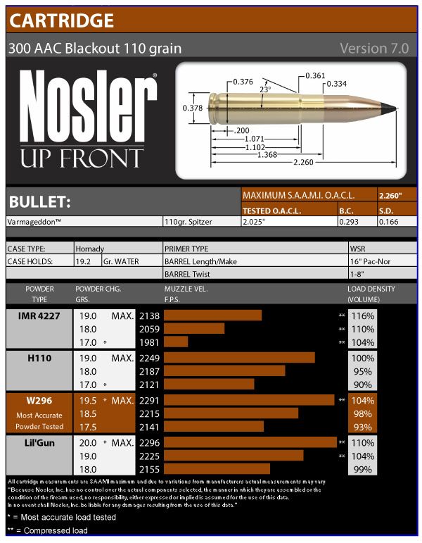

Not sierra but this Nosler sheet shows 19 gr of 4227 is max and that the 17 grain min charge is a compressed load at 104%
300-AAC-110gr-version-7-0_zps87fdeb46.jp
*Added pic

i did call sierra today, and the tech did say that the info on the website was correct, and that the charge of 20.3 is correct for the minimum load.  I mentioned that at that charge that it was near a full cartrige and he said that was correct, go figure, but I will load a few test and see.  thanks for the response.
A lot of Blackout loads are right at if not at or above 100% case capacity (compressed load) I know how you feel though because no matter what caliber or powder i'm loading, it always makes me cringe a little when I know that the bullet is going to "smoosh" the powder. I'm shooting a 125gr Nosler BT bullet for hunting and i'd have to look to be certain but i'm pretty sure i'm 100%+ on that load and they shoot nicely.
Ya I loaded 35 last night with 20.3gr and it was right at the top of the case, when we did it, sort of gives an unnerving feeling that something is going to go wrong when those rounds are fired.  I am curious to find out how they are going to shoot, will know soon enough.
