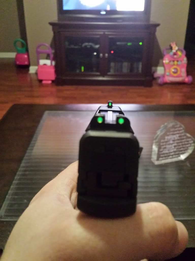

I'm a big fan of truglo TFO sights. They are tritium night sights with fiber optic light pipes. I have them on a Glock 26 and on an XDS 45.
Pic of them on the XDS :
Nice! How much they run for the XDs and how much do they cost to have installed?
Or is it easy to DIY? Not sure I could get them perfectly center unless the gun has a notch it clicks in to.
I got them on black Friday last year. I can't remember where I ordered them from but they were running a buy one get one half off deal.
I installed them myself using a punch. There are marks in the dovetail that you can use to line them up with but I just marked the slide with a pencil and lined them up that way.
