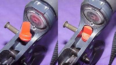

Has anybody used the "tension screw" thing on the CMT lower?
Seems like to me if a lower and upper were so unmatched as to actually rattle or something, adjusting the screw upward to make solid would also leave a gap between them?
Anyway, my pistol upper fit uber slickly onto the lower, was just wondering.
- OS
I'm far from an expert, but I think the tension screw is just an added feature that makes their already top of the line products another cut above the rest. If needed at all, I suspect it would be with an upper other than a CMT. I don't think it's designed to be cranked down. I imagine just enough pressure to snug it up a bit is all that's needed. Either way, it can't hurt.

... imagine just enough pressure to snug it up a bit is all that's needed. Either way, it can't hurt.
Well, it would "firm" it up, but since it presses against upper, would actually spread the two halves more apart rather than bring them closer together.
- OS
- OS
But, you have to think too, the only thing it can do is take out any play. Can't separate them any more than what your take down and pivot pins allow. I've got a couple billet lowers with the feature, though I've never actually used it, I think it's a good idea if nothing else
- OS
I see what your saying, but if there's enough play to separate the two halves that much, it's time to think about replacing something.
I don't think they've come up with a way bring the receivers closer together, so this is the next best option.
You're making me think too hard.
- OS
That set screw is a great feature. I wish I had it on all my lowers. I have a couple of rifles that are loose. I had to beat my rear pin in with a Delrin punch on the TGO set. But, over time, those holes can loosen up. Anyway, it's there to compensate for tolerances. Lots of billet lowers have them.

I don't think they've come up with a way bring the receivers closer together ....
Accuwedge does some, by basically adding thickness to the lower:
But still, I guess it is a nice feature. Certainly anything that makes the upper not wobble is good.
- OS
