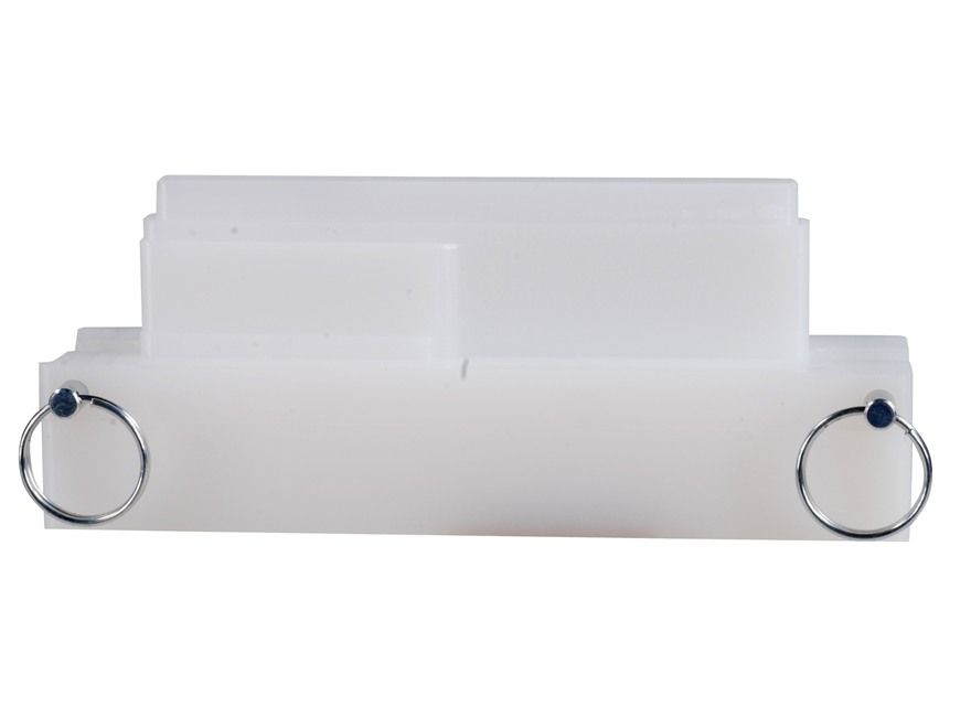

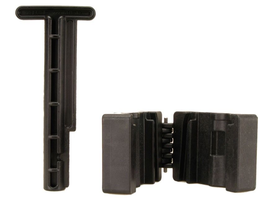

I just checked, and the clamshell type upper receiver vice block doesn't work on these receivers. The DPMS Delrin block works fine, even though it's a tight fit.
WORKS...
DOESN'T WORK...
Well that sucks.

Dang. I think the kit I bought has something like that clamshell. I guess I may be working out how to print something up.

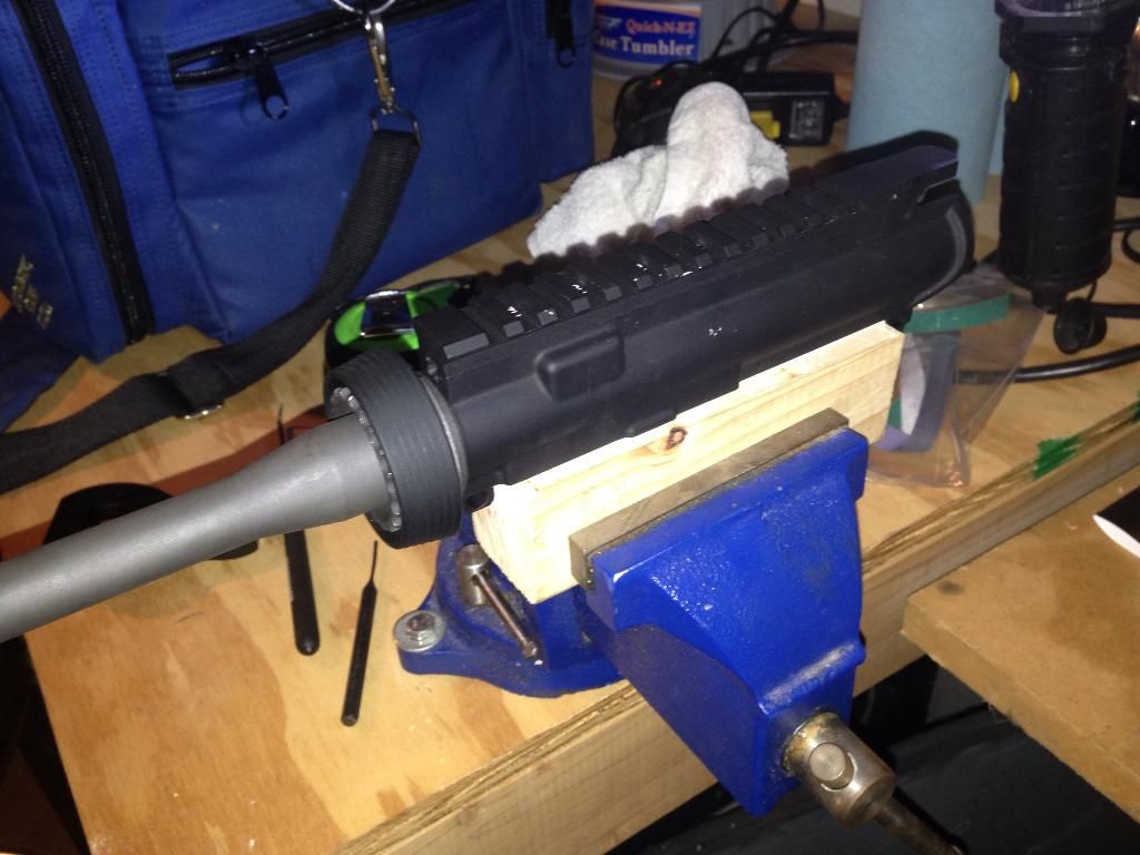

Guys, if you have a 2x4 and a router (not the Cisco variety ;) ) you can make your own vise block like the one Mike pictured above. I didn't think to put in the holes for the take down pins, but it worked. Next time I'll add the holes.

Never thought of that. You sure don't want to do it wrong. A friend of mine, who shall remain nameless, wound up with a twisted upper receiver. I don't know the details, but do know that the receiver wound up in the can.
That's pretty cool, Lagerhead. I'm going to do that with a piece of oak. That's one thing that can be made. I have the black clamp in
type. It's not very good with the milspec upper, but it does work. Of course, I'll have to get a couple of CMT's uppers. :D
I was thinking hardwood too. As you know, I usually lose the barrel nut lottery, and wind up having to put some eye popping torque on some of them. This first TGO upper is getting a Lite Rail, so the nut will be torqued at 30.
