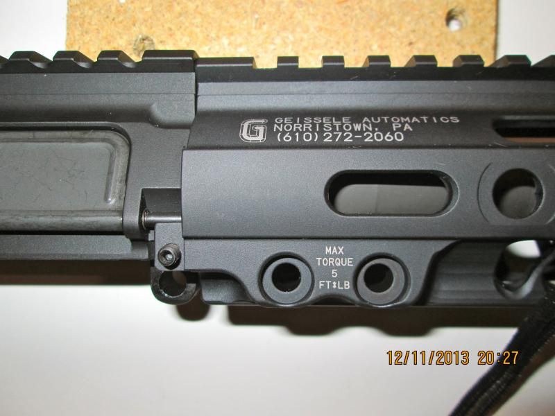

The upper and rail is mated, but this is without the barrel nut.
[url=http://s19.photobucket.com/user/sigbrown1297/media/ar15/IMG_0205_zps6ff24cf4.jpg.html]IMG_0205_zps6ff24cf4.jpg[/URL]
Another shot of the upper and rail without the barrel nut.
[url=http://s19.photobucket.com/user/sigbrown1297/media/ar15/IMG_0204_zps25966c31.jpg.html]IMG_0204_zps25966c31.jpg[/URL]

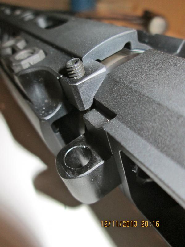

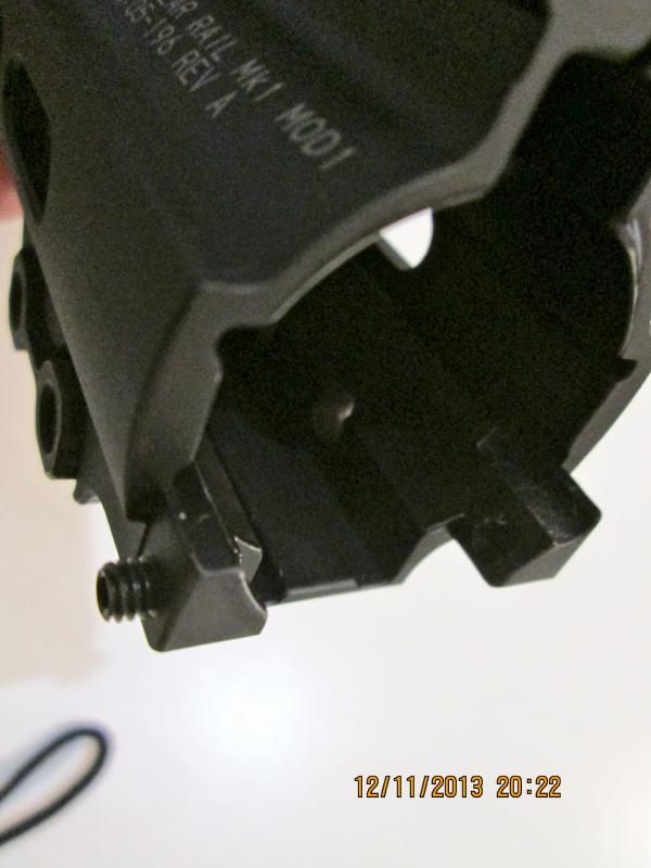

​Pic of the locking tabs that slide over the upper.
[url=http://s19.photobucket.com/user/sigbrown1297/media/ar15/IMG_0203_zps902e5d08.jpg.html]IMG_0203_zps902e5d08.jpg[/URL]
[url=http://s19.photobucket.com/user/sigbrown1297/media/ar15/IMG_0200_zpsa2474363.jpg.html]IMG_0200_zpsa2474363.jpg[/URL]

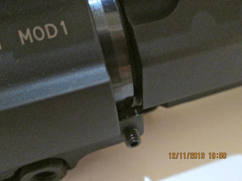

Upper and rail with the barrel nut installed.  You can see that the upper has too much material to slide under the locking tabs.  there is about a 1/2inch gap between the upper and rail since the rail cannot mate up against the upper.
[url=http://s19.photobucket.com/user/sigbrown1297/media/ar15/IMG_0199_zpsc074dd67.jpg.html]IMG_0199_zpsc074dd67.jpg[/URL]

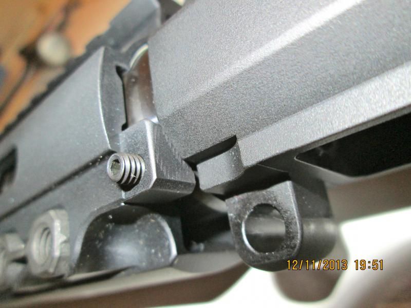

Another shot showing the No Go.  Its just hitting the lower corner of the upper.
[url=http://s19.photobucket.com/user/sigbrown1297/media/ar15/IMG_0198_zpsc44a02da.jpg.html]IMG_0198_zpsc44a02da.jpg[/URL]

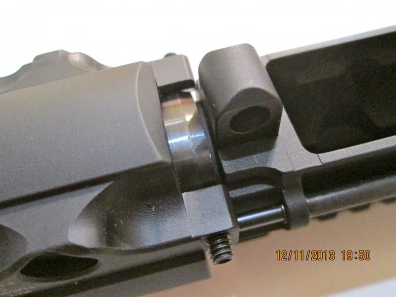

​Gap between the upper and rail.
[url=http://s19.photobucket.com/user/sigbrown1297/media/ar15/IMG_0195_zps351764ef.jpg.html]IMG_0195_zps351764ef.jpg[/URL]
Bottom view showing the gap.
[url=http://s19.photobucket.com/user/sigbrown1297/media/ar15/IMG_0193_zpsab3100b7.jpg.html]IMG_0193_zpsab3100b7.jpg[/URL]
