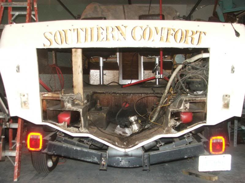

Little history of this boat. It's a 1972 Winner Viscount 21'. It's been in my family since day one. In 1979 to 1980 my dad took a chainsaw to the rear and made it an inboard and dropped a 350 chevy engine in her. In 2007 or 2008 it sank while I was deployed. My dad gave it to me as a 20th birthday present and rebuilt it while I was on my first deployment. Thats when I came home and repainted it and made her perfect. Or so I thought...

I do wish I took a picture before we started. But I might be able to find an old one of it.

After it sank, and I was gone and my dad rebuilt it.
