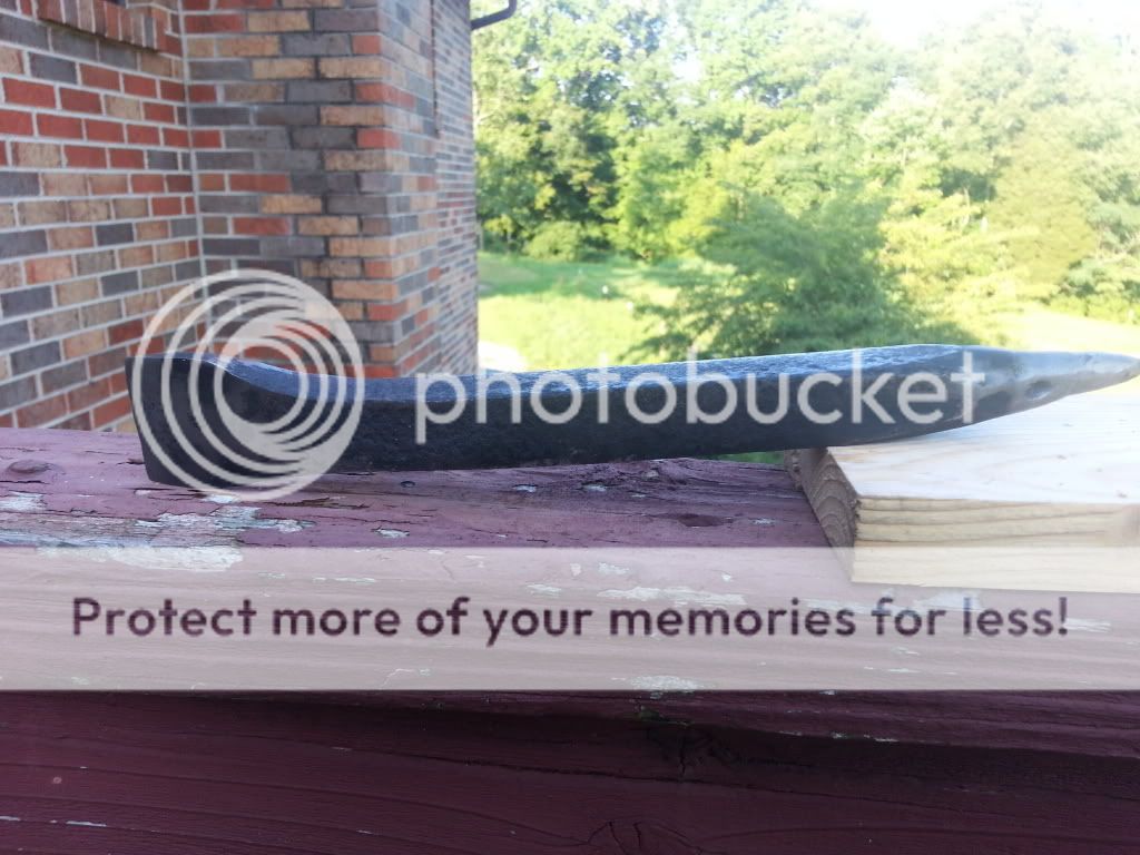

And I made a small prybar for my get home bag that may end up as an edc item with a custom kydex sheath. Its built from a harrow spike, about 1080 steel. Tempered for toughness and to give it some spring so it can be hammered on without mercy. Head it 1.5 inch wide with a blunt chiesel tip. The spike on the back is designed to bust auto glass. Its 9.5" tip to tip.

As to the wrecking bar, that is one sweet piece of gear. Looks brutally efficient.
Thanks man, I really like that blade. I wanted something lean and mean with a classy feel to it. Almost a gentlemans fighting knife. And yeah the prybar is an idea I've wanted to do for years and finally decided to make one.
