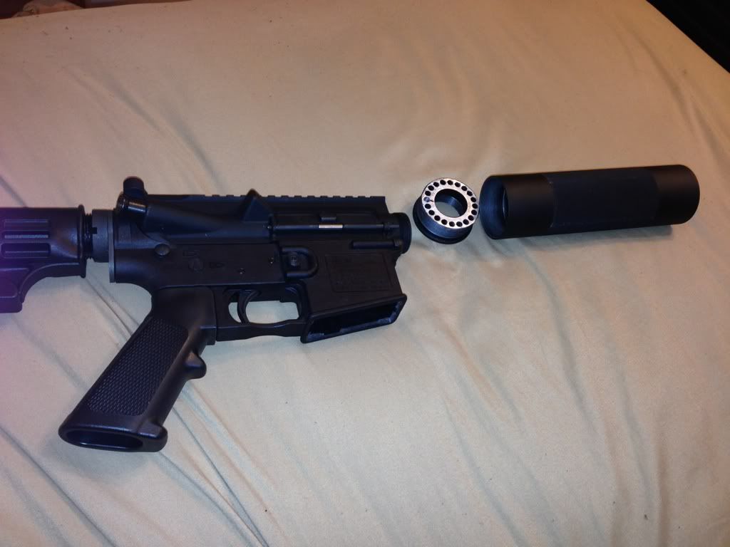

According to this video from Brownells it looks like everything that I want to do is very much possible. I did notice that it doesn't look like he used a delta ring or crush washer. Would I be able to get away with the same? This is what I have so far.
49D54B36-0D03-4D8A-BD86-E3580C74FAAE-265
Also a bit curious as to how I would go about finding out which gas block/sight mount would be a good fit for my upper. What measurements would I need to take to make sure I'm buying the right one?

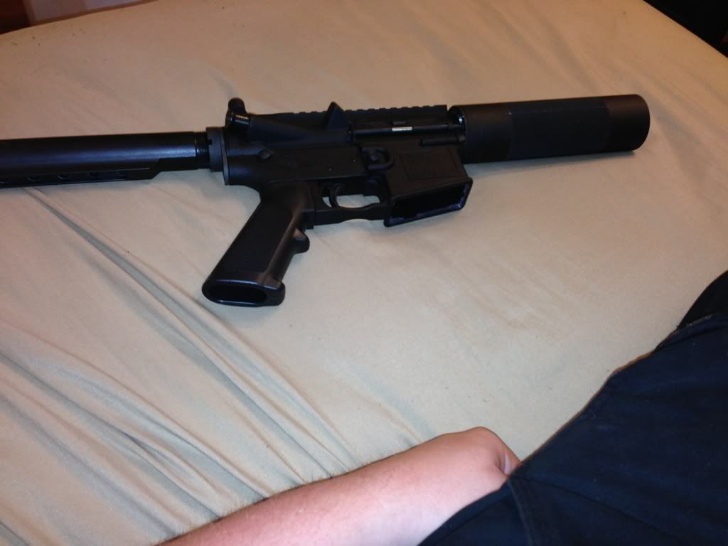

Edited to add that I am seriously considering making this one a pistol instead. It just looks so damn cool with what I've got put together.
692EC1C2-5DA9-4643-ABBE-76A705C1BD55-265 Edited by TrickyNicky
