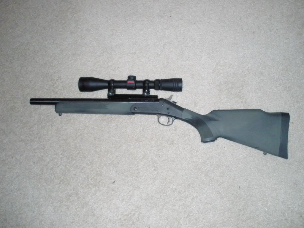

This just came back from D&T Custom.  It was a handi in .357 Mag.  It is now a .357 MAXIMUM with the barrel cut back to 16 1/2 inches, a trigger job and a scope rail bedded with glass.  The 3-9X scope is for load development.  Then I get the right loads, it will wear a Weaver V-3 for the woods.
The ideal load will be a 180 gr. spire point bullet around 2100 fps.  I am working up loads with AA1680 and lil' gun.  After the hunting load, I am going to find the sweet spot for 180 gr. cast bullets for range and plinking fun.  As soon as I figure out how to use my new chronograph and get some loads worked up I will post back with a range report.
