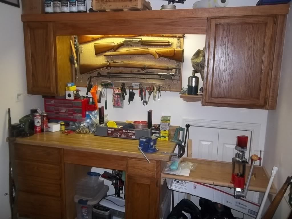

While I liked the "enooks" the hospital had, I would definately build my own so that it would be a little deeper, and have more shelves. I just liked their execution of the idea well enough to want to copy/improve on it in the future.

Over christmas I put one of these Lowes stainless workbench in my bedroom. Its not a built-in, but was just pleasantly surprised at the quality of the item for the price. The stainless model costs about $300 and they make a virtually identical painted black model in the ballpark of $200. Edit-- This is a nice man-cave workbench for the money, but I would not use it for reloading. Maybe it would be good for reloading but I'd want something stiffer to attach a press.
http://www.lowes.com/pd_315789-55738-LWWB09-3DSSMT_0__?Ntt=stainless+workbench&UserSearch=stainless+workbench&productId=3283992
For an oak floor, rather than attaching casters for easy moving, just sat it on those 4" X 1" thick foam "slider" floor protector discs and it moves easy if necessary without scratching the floor. The "engineered wood" top looks a little better on the stainless model than the black model, on the samples I saw. Maybe varies with model, but mine is bamboo and at least some of the black ones are MDF.
It was not annoying to assemble and very rigid out of "surprisingly thick" steel. The drawer sliders work great and are very useful drawer space. That top shelf with the piano-hinge cover is dang useful. Comes with a flourescent work light and small AC outlet built-in. Both features real useful in practice. There is "too much" direct-lighting glare from the light. I had a roll of 4" wide aluminum sheet metal flashing, and cut off a piece long enough to wrap around the front of the shelf and both sides. Folded crimps in the ends of the flashing so it wouldn't be sharp and cut the hands, then attached it overlapped 1" with the bottom outside edge of the shelf, to make a glare-shield. I attached the flashing with double-sided carpet tape and it is on there forever as best I can tell. The aluminum flashing color matches the stainless real well, looks like it was designed to be thataway and keeps the direct-light glare out of your eyes.
