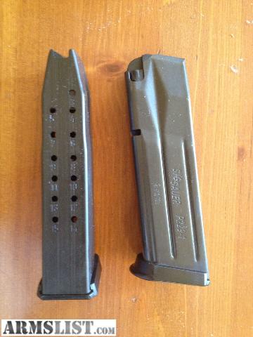

Yeah, the giveaway on the new 9mm mags is that they get slightly wider a few rounds from the top. (all the factory mags are labeled 229-1 but some aftermarket mags may not be) if the wider mag will fit into the mag well it is the wider frame. (all .40 and .357 229s should be on the wider frame as that is why the frame was widened to begin with)
539369_01_sig_sauer_p229_1_9mm_magazines
