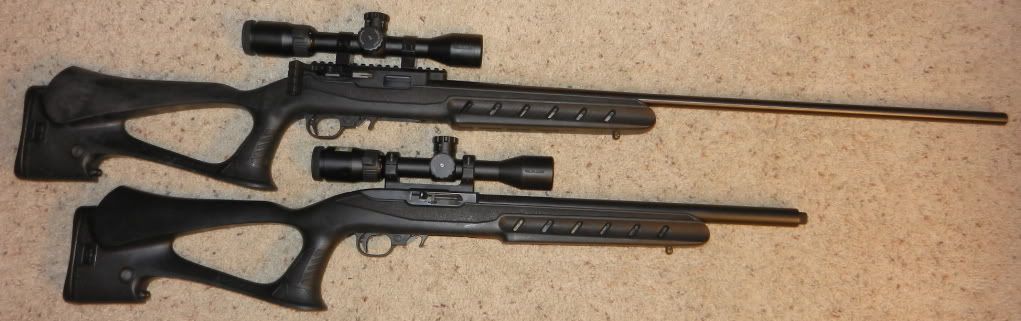

Pictured is a pair of 10/22s. Both sport Promag Archangel Target,Nikon P22 Nikoplex 2-7x32 rimfire scopes and Kidd trigger kits in OEM Ruger trigger housing.
Top has PWS T3 Summit Toggle Receiver, URS 29" barrel. It is a joy to shoot off the bag or offhand, balance is suprisingly superb.
Bottom is a threaded Capitalist Arms 1:11.25 twist barrel that although hefty slings 60grain SSS well and surprisingly throws standard weight rounds down range nicely also. Another cool thing about this 10/22 is that the bolt was redone by our own Dolomite Supafly. Thanks Dolomite! I have two barrels that I am swapping back and forth on this 10/22, the 1:11.25 and a standard 1:16 twist sporter that has been rechambered by Rimfire Technologies. The jury is still out but I am leaning on making the 1:11.25 twist the permament partner to Dolomite's bolt.
