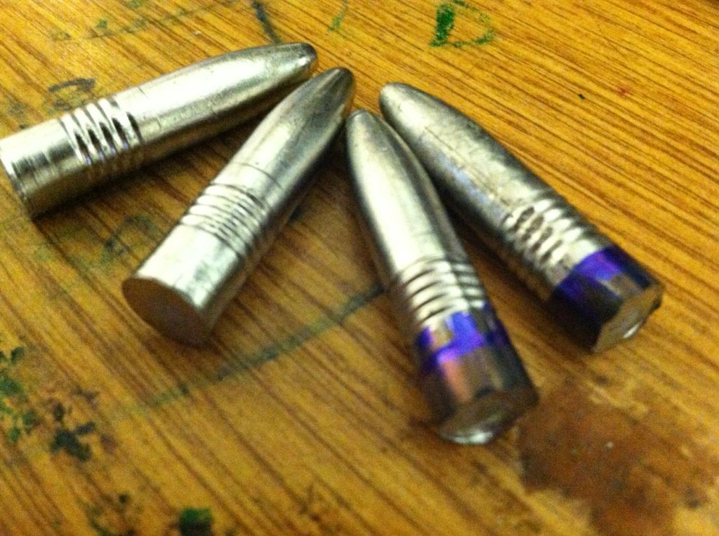

I bought the Lee 230 grain Blackout mold but could not get it to shoot ver well. I was told by a few, Caster and DLM37015, it was the boat tail. Well yesterday I decided to either fix the mold or ruin it. I took a chamfer tool and cut the outside down to ~.311 OD. That way it will make a straight cut. I took a clamp and used it to hols the Lee mold closed. I then chucked the chamfer tool into a drill press. I held the mold loosely so it would center itself. I ran the chamfer tool down into the mold, removing the boat tail.
After casting them I size them down to .311" and then tumble lube.
Here is how they look now with the boat tail removed.
The blue was so I can see how the sizing is working.
