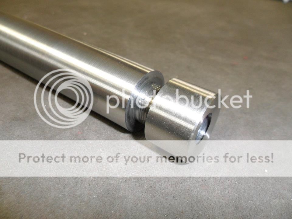

Post a pic of the slick way that Brandon threaded the first rifle. Its one of the best examples of how to make a "cover" for the end of the barrel when not using a suppressor.
For those looking at the pic - - - The barrel has the cover in place. Its such a fine bit of gunsmithing that the barrel looks to be one solid piece! :up:
DMark, Here are the pictures of the B.A.T. that you requested.
I didn't end up getting a picture of the muzzle, it was done on an 11 degree crown from the barrel to the thread protector.
