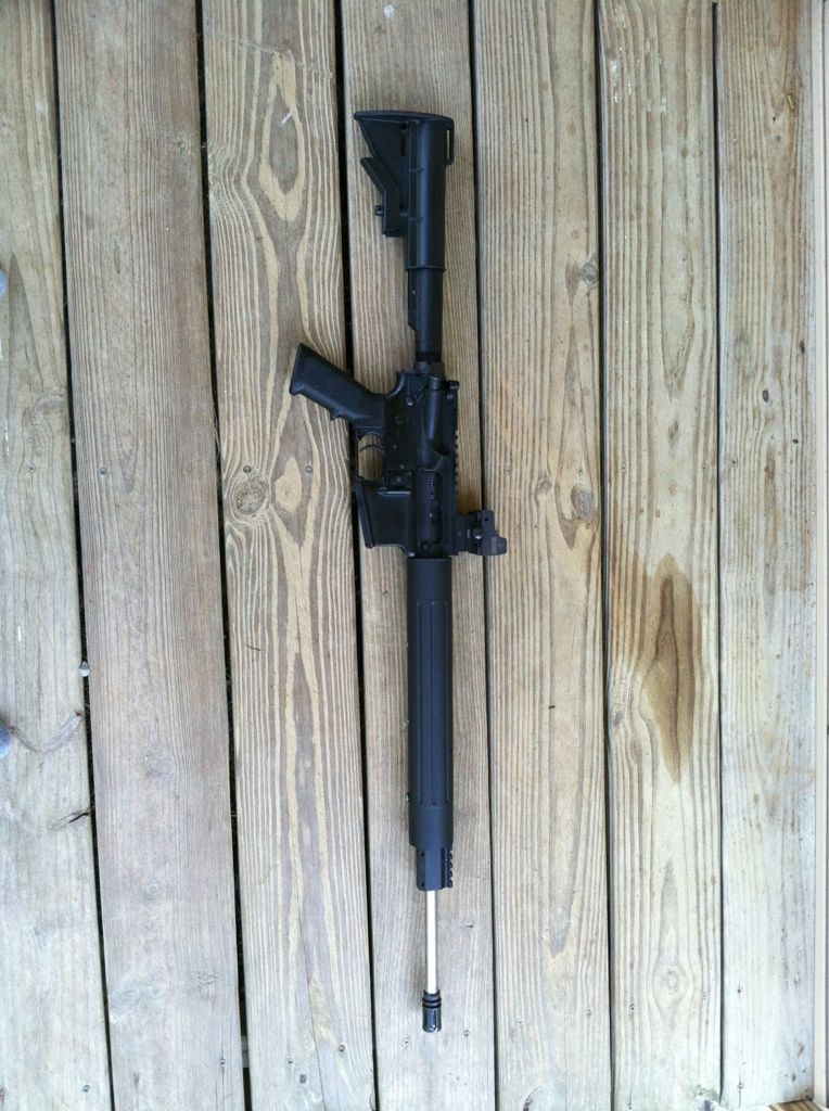

So I have got everything assembled and test fired now. It is not Wolf friendly and will not cycle enough to even lock on an empty magazine. That is fine by me because I plan on reloading anyways. It does cycle 62 grain M855 great.
I have decided to go cheap rather than light, I knew I would have to pick one. But as it stands right now it is 6 pounds on the dot without optics and 6 pounds 4 ounces with the Fast Fire. I used a $35 Model 1 Sales free float tube that weighs a metric ton compared to some of the purpose built lightweight rails.
I am thinking I can shave a few ounces by going with a minimalistic gas block rather than the chunky aluminum one I currently have. And bring it in under 6 pounds with the Fast Fire.
Here is a picture at 6 pounds 4 ounces:
If I decide I am actually going to use this I will spend the $180 for a lightweight rail and another $150 for a complete polymer lower.
As it stands right now I have less than I expected I would have in the entire upper not including the BCG. Now I need to work up some handloads and take it to the range to see how it performs. I know with the extra barrel I can push the 53 grain SMK's to probably 3400+ fps or 40 gran Vmaxes to 3600+ fps.

Don't thank jeff thank me since that carbon fiber came off my gun lol. What are you going to do with the tube that was on your rifle. I like that plain jane looking one.
Those Model One tubes may be heavy, but they're real good for the money. I have one of their rifle length tubes on my heavy rifle.
Carbon fiber beats a light rail system in weight, correct?
