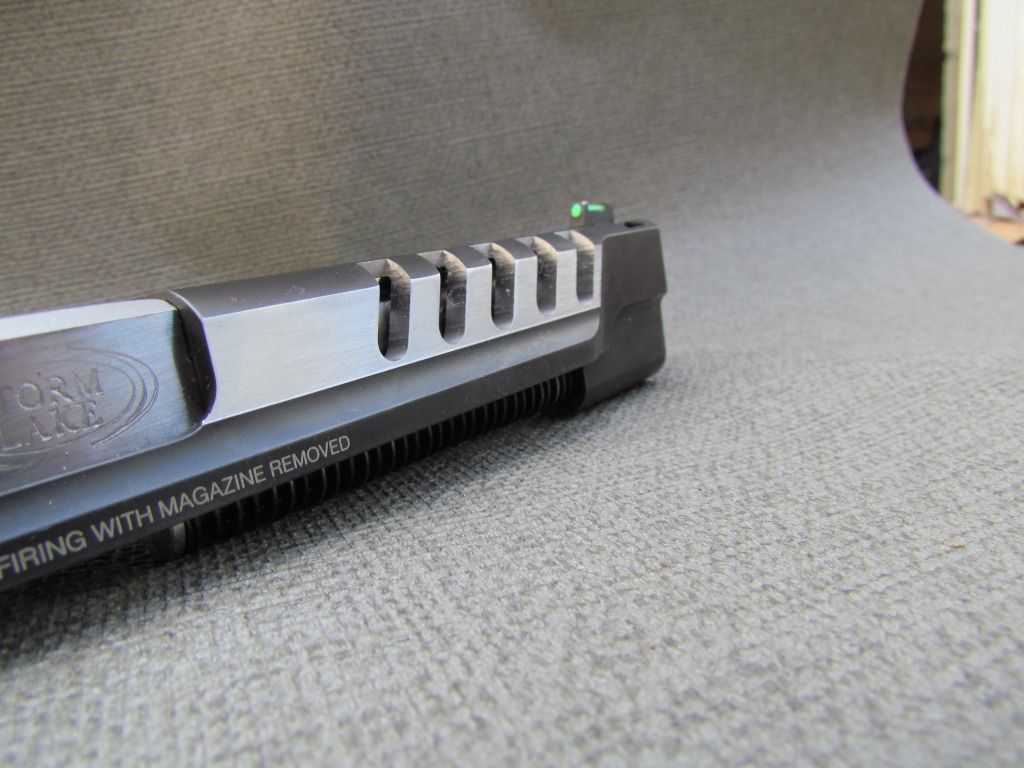

Good to know about the 5R. I can sure attest to the toughness of the S&W finish. I just finished a slide for a M&P race gun and the hardest thing about doing the cuts was getting through the finish. :lol:
