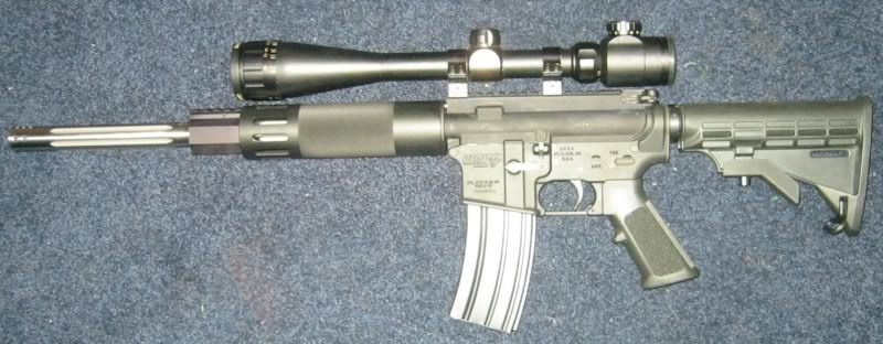

my build is finally done:D
tell me what you think

What barrel do you have on that?
The scope and stock are mismatched. The CAR stock doesn't give a lot of solid support, making precision shots difficult. I would have gone with an Ace Skeleton. But then, I did go with an Ace and love it.

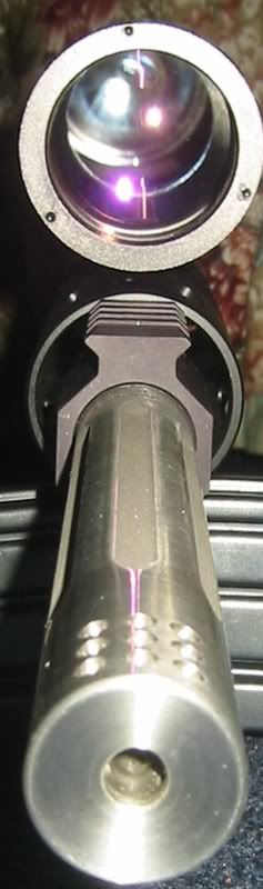

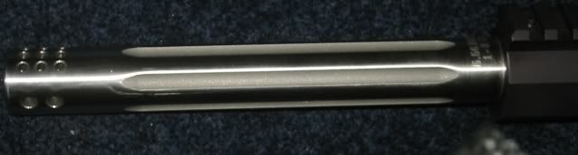

it is 5.56mm Ultra Match Stainless steel Fluted and ported barrel 1x8 twist.

porting on barrel did eliminate any barrel rise.

first the scope rings, way to low
holding it in hand felt good, but shooting from the table Way to low.
than my scope was way to off , waaaay to off icon_smile_sad.gifdial it all the way and still it was 10" to high and 4" to the right.
new rings will fix that problem, sadly didn't had any on me today so i didn't do any groups shooting, so it was only about reliability.

About wobbly telestocks - get yerself a Magpul CTR. Snap the bottom lever and all the play is removed and it feels as solid as a fixed stock. (High CDI factor on it, too.)
Also, you can put a bipod stud on the bottom front of your float tube and add a Harris bipod to it. It'll be easily removable but a sturdy mount.
Mags - shop around for some good surplus 20 rounders. Never, ever, ever buy the cheapest mags you can find, and for God's sake stay away from USA mags in the AR.
About your scope mounting - you can try a pair of risers - spacers - that'll raise it up a half inch or so, or you can get an Flattop-AR-specific scope mount. Sounds like your rings aren't holding your scope exactly along the centerline of your bore though. You can get a decent mount for what you'd have in another set of rings and risers, and it'd most likely hold the scope closer to your mechanical zero.
You may want to boresight your scope when you play around with the different rings and stuff. The AR is very easy to boresight - just take your upper off and remove the bolt. Set your upper in such a way that you can see some distant object in the center of your bore and adjust your scope to match it. I like to use a light that I can see on the top of a mountain.
Scope size: Mount what you like. The bigger the scope's objective, the more light it brings in. The longer it is, the less 'bending' that the objective has to do to the light. Less bending = less distortion. More light and less distortion = greater detail. All that plus a free-floated stainless barrel means one mean little target rifle!

J&T upper and barrel.
http://jtdistributing.net/contact.html
barrel OAL is 16", but do to porting barrel ends 1" inside, so its 15"

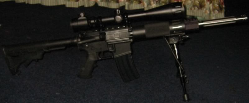

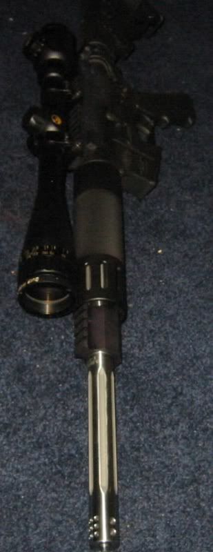

first i ended up buying a Laser for my scopes.
finally i was able to adjust my scopes. but still didn't test it yet
i got Bipod to,
i had i problem with my trigger pin walking out,
i polished the grove and got lucky that spring is holding it in place,
so im hoping that i fix the problem, if not i will order some of those anti-walking pins

so far it looks like this, it is still work in progress
