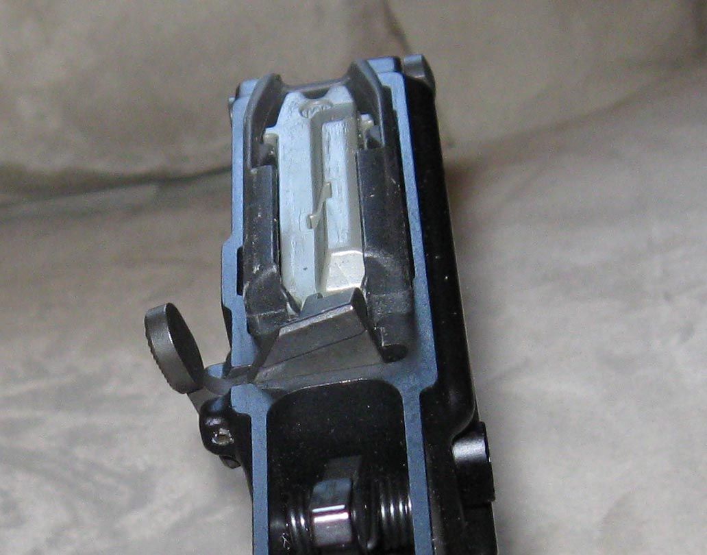

I purchased a new CMMG complete upper. The bolt catch on my lower does not retain the bolt carrier in the open position. What can I do to resolve the problem?

I will pull it out and see. I may be wrong but I thought there was only one way to install the assembly.
There is. But there's a remote possibility that something went wrong, like getting springs mixed up. If you get what's in the picture, it could be something else. You also may not be aware, it's possible to break the bolt catch if you drop the hammer on it full force while the gun is disassembled.

I took your advice and pulled the catch assembly out. I determined that the catch was not coming up enough to catch the bolt carrier properly. I took the catch and removed a few thousands off the area that meets the spring pin. The catch is now coming up suficently to hold the bolt carrier back. That seemed to do the job. Thanks for pointing me in the right direction. I will be sure to help another brother out in time of need. Thanks a million.
I wish you had taken pics of the spring and pin behind the bolt catch. You shouldn't have had to file anything and its likely that there is still a wrong part in there. Its possible that you mixed up the pins or springs. Its kinda easy to do. Its one of the reasons that I like how CMMG is now shipping their lpk's, they are in color coded bags for different parts.
There should be a plunger on top of the spring. There should be a spring, a plunger on top of the spring, then the catch installed over both of them.
