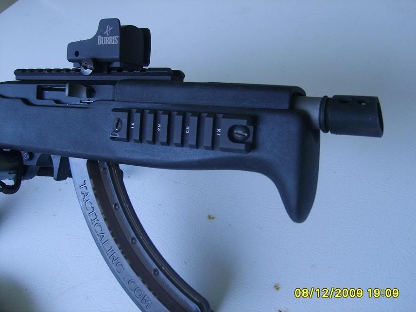

Been through the Charger phase. I completely transformed one and liked it but in the end a standard pistol did what I wanted and did it better.
Dolomite
im curious what was it about the charger you didnt like for a supressor host? i only ask because i was considering one as a host if/when i get into the supressor market
It is that the Charger is too big to be used as a pistol and too small to be a rifle.
Here was my rework:
In the end I sold it. Not because it wasn't fun but for me it served no purpose. And it was a complete rework, trigger, barrel work, bolt work as well as what you see. It was a very reliable and very accurate gun but for me it wasn't something I could use.
