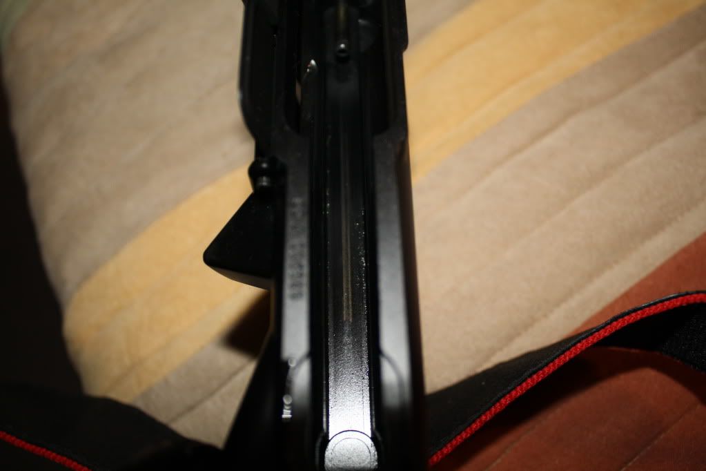

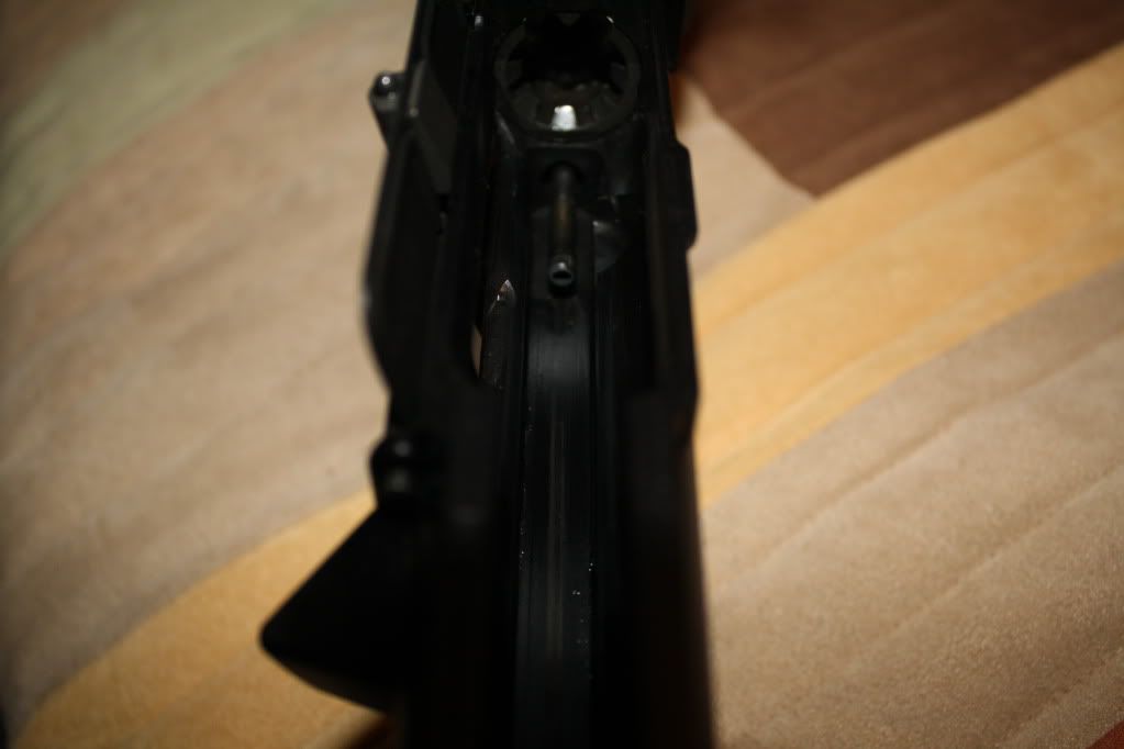

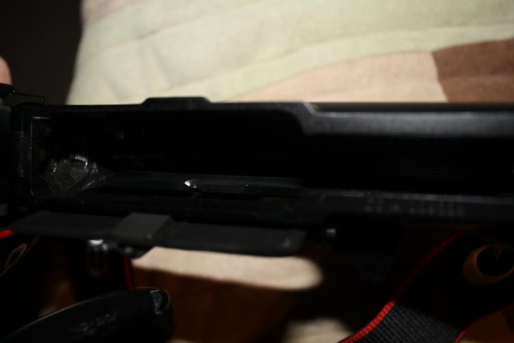

Upon bringing the DD rifle home, I noticed that the action was very gritty in hand cycling. I’ve seen on other posts that hand cycling with a good deal of lube will help to smooth things out and parts will wear in. When I did so, I observed a good deal of metal shavings on the charging handle and a good deal of wear on the upper receiver (on the anodizing I'm assuming). I would take the gun apart, clean the shavings off, lube, assemble and then cycle the gun a few more times—then repeat. I will say that the action has become noticeably smoother and I don’t see near as much metal shavings after doing this several times, but I am still somewhat concerned. There was also an odd smell, like a burning smell, which I assume is the phosphate coatings on parts were rubbing together while doing this. There is no wear on the BCG.

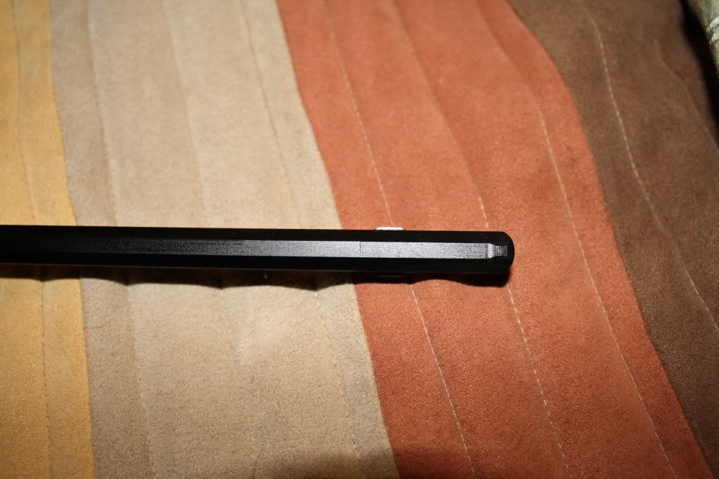

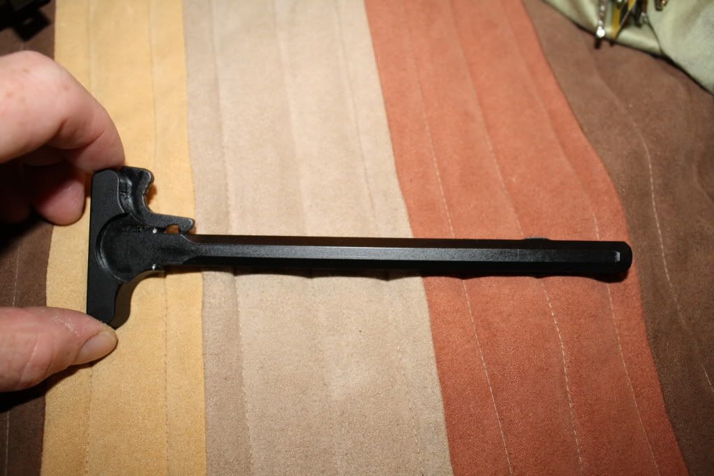

The charging handle has worn off a clean line on the upper receiver, which has a noticeable valley that can be felt. The charging handle itself also has noticeable wear.
The first set of pics are of the gun wet with lube. You can see some of the shavings of metal:
In this set of pics, the gun is intentionally dry:

I have taken apart and put back together a crap load of FN M4, Colts M4..A2 and A3's and have never seen that kind of wear from a charging handle on it and the upper. Especially on the anodizing on the inside of the upper. Something appear out of spec on a new rifle. I would take better pictures and email Daniel Defense on a new rifle.
Maybe others can shed more light. Bottom line I would want the company to repair it. Just goes to show that the upper end AR's have issues also.

It appears the coating on the rifle is flawed from your pics. One charging handle that wears is my BCM gunfighter but just the corners very faint, but not deep and digging like it appears on yours. Also the upper receiver will have some wear marks from the charging handle but not in one day. My Knights has some wear on the upper underneath the charging handle but it's got about 750 rounds down the pipe and 10 years of handle cycling the handle.

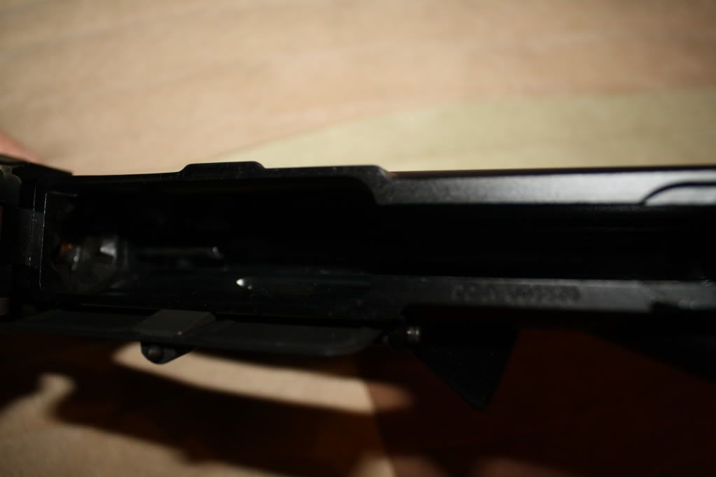

Here are some pics of mine in the same areas as yours. I do have some very minor wear on top of the buffer tube from the charging handle but it hasn't gone through the finish, and could probably spend some time cleaning and it would disappear. Hope this helps...

That helps tremendously! Gives me a good reference point to use if needed when talking with DD. Thanks for taking the time to do that!

It looks like just about the only thing they did was replace the charging handle, since it showed no wear whatsoever. It continued to remain wear free after hand cycling the gun approximately 40 times and there are no more metal shavings. They did lube up the gun with some type of grease, which was different than the normal goupe that came on it new.
So I guess I can simply assume that they had an out of spec charging handle and replacing the charging handle solved the issue to their satisfaction. I'll take it to the range this weekend and make sure that things function as they are supposed to and if so, I reckon I'm satisfied as well. I still have peace of mind in that they will continue to honor their warranty for the life of the gun if I have another issue.
