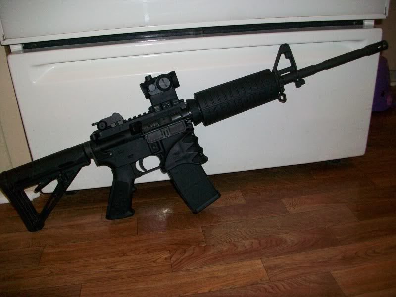

Definatly look around at gun shows for what you may need for your build. A lot of good parts can be had for dirt cheap. Here's my AR....Definatly like the P. Arms microdot....works well and co-wittness' in the lower 1/3 of the optic. Pmags are cheap and a great way to go.....definatly didnot like the Mako magwell grip...it's already off of the rifle...
