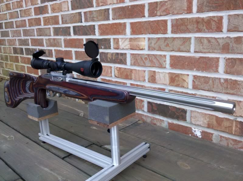

I have had an Evolution on a previous 10/22 build and am using a Blaster on the gun I have now. Boyds make excellent products that really can't be beat for the money. I believe thier Tacticool stock is ambi also. Another site to check out is www.stockysstocks.com. Similar to Boyds. Or www.rifle-stocks.com. There is a guy in Manchester TN that hand builds stocks. Seen his work..wow, dude can checker a stock now! I could get his info if your interested. AS for "good" inexpensive scope. You will get a million opinions here. Redfield is hard to beat for the money. American owned and operated, crystal clear glass and 1/3 the price of a Leupold. Cant give advice on the octagonal barrel. I have a GM fluted stainless on mine. Sounds like you have done some homework, and plan to build a great little plinker.
