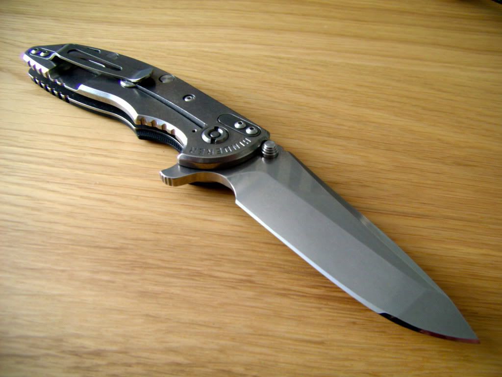

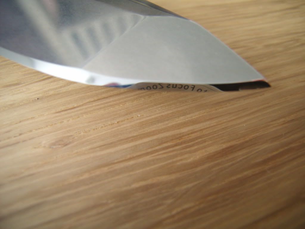

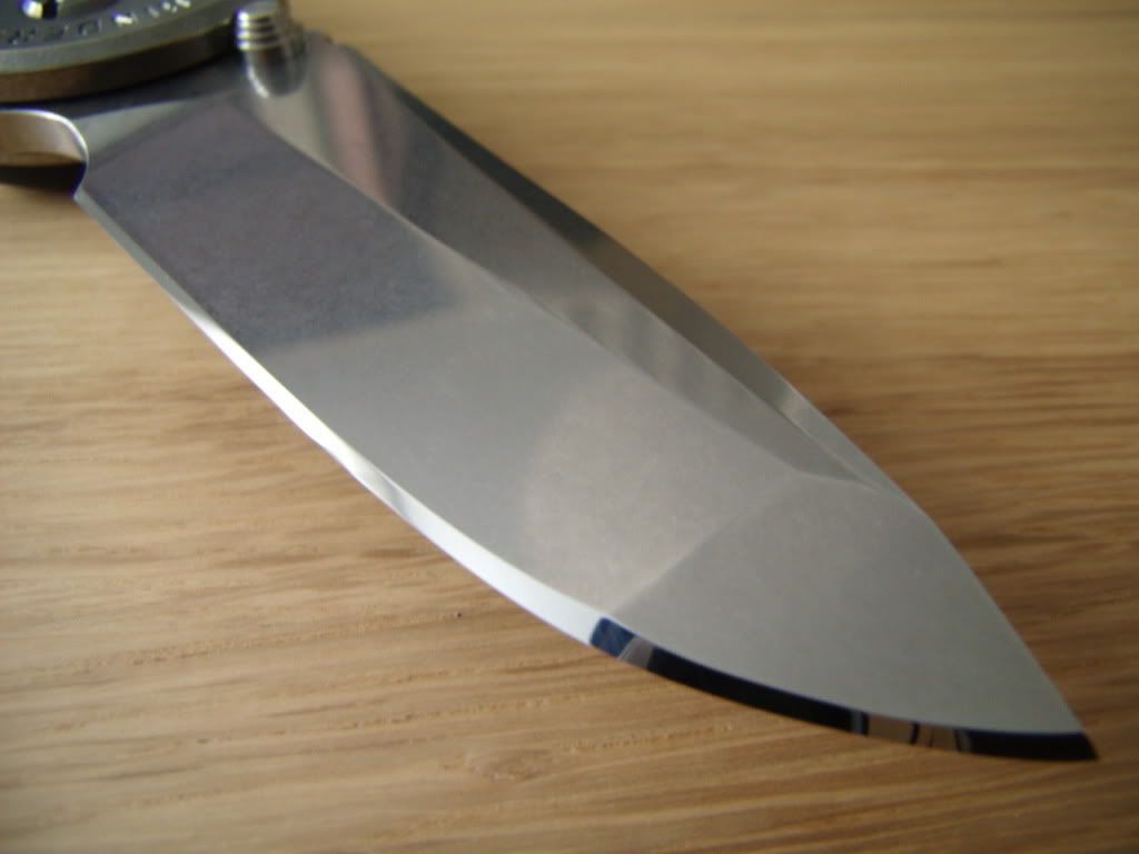

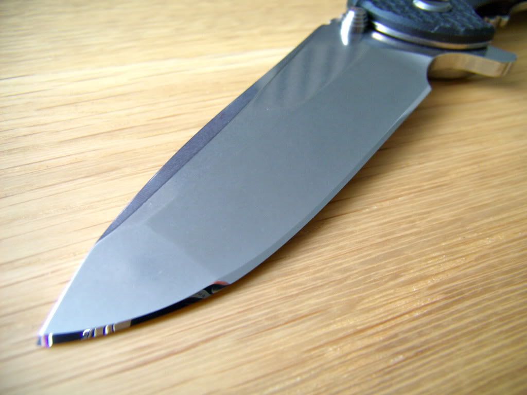

I use 40 degree, 20 per side as well with my Edge Pro most custom knife makers go this route as well it works for my knives, I am however thinking of getting a Wicked Edge sharpener after seeing the edge that a Dutch friend of mine put on his XM-18 Here is sharpening perfection in my opinion
Edited by willis68
I honestly don't know if I'm more jealous of the ability to put that edge on a knife or the ability to take those pictures

Wow I am jealous of that edge. Just look how smooth and shiny it is! I have a Lansky system which I like. The fine stone is a 600 do I need a finer stone to get sexy edges like this?

That is beautiful.
