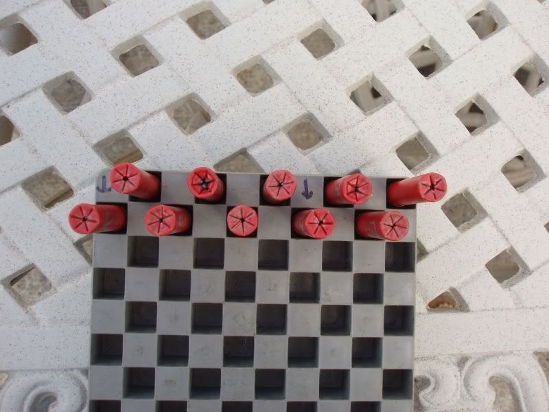

Update... I loaded 10 using the MRC hand loader, and they came out just fine. I had to put an extra step between the start crimp and the final crimp. I used the end of the prime tool, which is wider than the ram rod used for the final crimp, and hand manipulated the folds of the crimp further closed. The final crimp went well, and they shot well. I only shot 5 of them at 10" paper plates, and they shot good. Some of the crimps were a little open in the center, and smaller shot just might fall out. But, I was loading #6 lead shot, and they did fine. I'll attach a pic of the crimps, if I can figure out hoe to post pics. May buy a new MEC tomorrow from Grady Jones' Gun Shop in the B'oro. I believe $180 out the door, is reasonable, and you don't have to wait for UPS!
