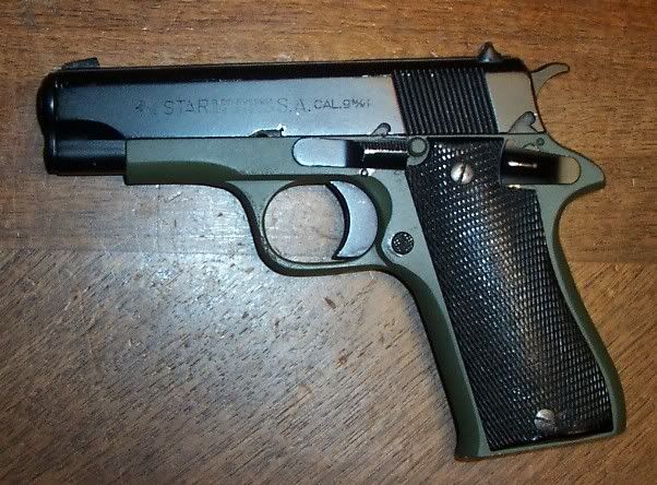

If you go through the pics you will see three (3) 9mm Stars I own: a black BM, an OD Green BM and a "blued" BKM (aluminum frame) Star. I put aftermarket springs and firing pins in these guns and they are great shooting guns.
Just for giggles: with no mag the BKM weighs 22.5oz and the BMs weigh 31.5oz. A 1st Gen Glock 17 weighs 21.9oz w/o mag. If you want a review of the Star BM by a respected and known gun writer/critic then here you go: A Critical Look at the Star Model BM

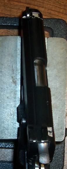

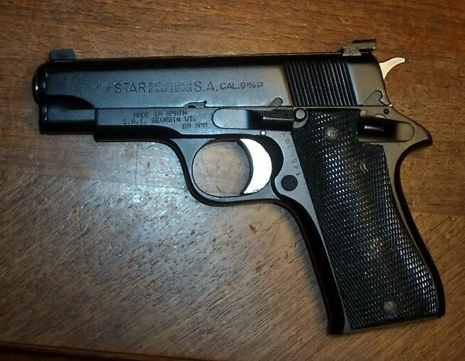

If you look at the pics of the Black BM you will see that its rear and front sights are much "nicer" than either of the other Stars' "GI" sights. However and unbeknownst to me and the guy I got the Black BM from, the guy who dovetailed the slide for the front and rear sights and installed the sights didn't ensure that the sights fit tight within the dovetail. Superglue and 2,000lb 2-part epoxy won't make these sights sit tight.
My question: Is there a way at my kitchen table I can make these sights tight? For instance: will JB Weld freeze these sights in place? Will Black Loctite work? Do I need to get a punch and crimp the dovetail to the sight?
The front sight will actually slide out when the pistol is tipped, while the back slide has to be slightly tapped out. Both sights fall out when the pistol is being fired. There is no going back the dovetails are cut. What is the best way to make sure these sights do not move?

I had this issue with a Star BKS many years ago. The only thing that worked was to remove the rear sight, carefully crimp the dovetail, the slide the rear sight into place with many small, gentle taps of the lead hammer. Then another crimping to lock the sight in. After that, your rear sight won't move any more, but can still be adjusted for windage by gentle tapping with the lead hammmer.
