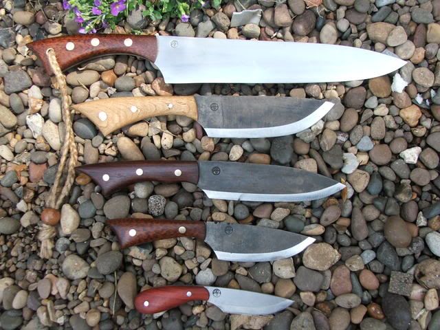

This one's been lying on my bench for quite a while. With all the rainy weather this past holiday weekend, I finally got a chance to finish it. The handles are linen micarta.

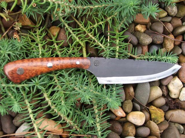

A couple I made a few months ago. I really need to work on my lighting in pictures....
[img]http://i31.photobucket.com/albums/c372/atomic_colonic/2012-08-22_09-36-51_1861.jpg[/img]
[img]http://i31.photobucket.com/albums/c372/atomic_colonic/IMAG0014.jpg[/img]
Guest Broomhead
Try taking your pictures outside in the morning or afternoon. Great looking knives.
