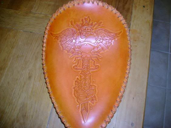

Years ago, I used to make motorcycle seats, which is why I had the left over leather. Here is the quick answer. Basically I would take a design that somebody sent or something I drew to their liking. First, you run the leather very quickly under hot water, just enough to get it damp, this is called casing the leather. Then I just taped down my artwork over the wet leather. Next you take an old ball point pen that ran out of ink (or buy an actual stylus) and trace over the design. When you pull the paper away, you will have a nice impression of your art in the leather. Next you cut on the lines with a swivel knife, and then use a beveler to to press down the negative spaces which makes your design pop out. That is the jist of it, more to it, but that is the basic idea.
Here are a couple of examples:
