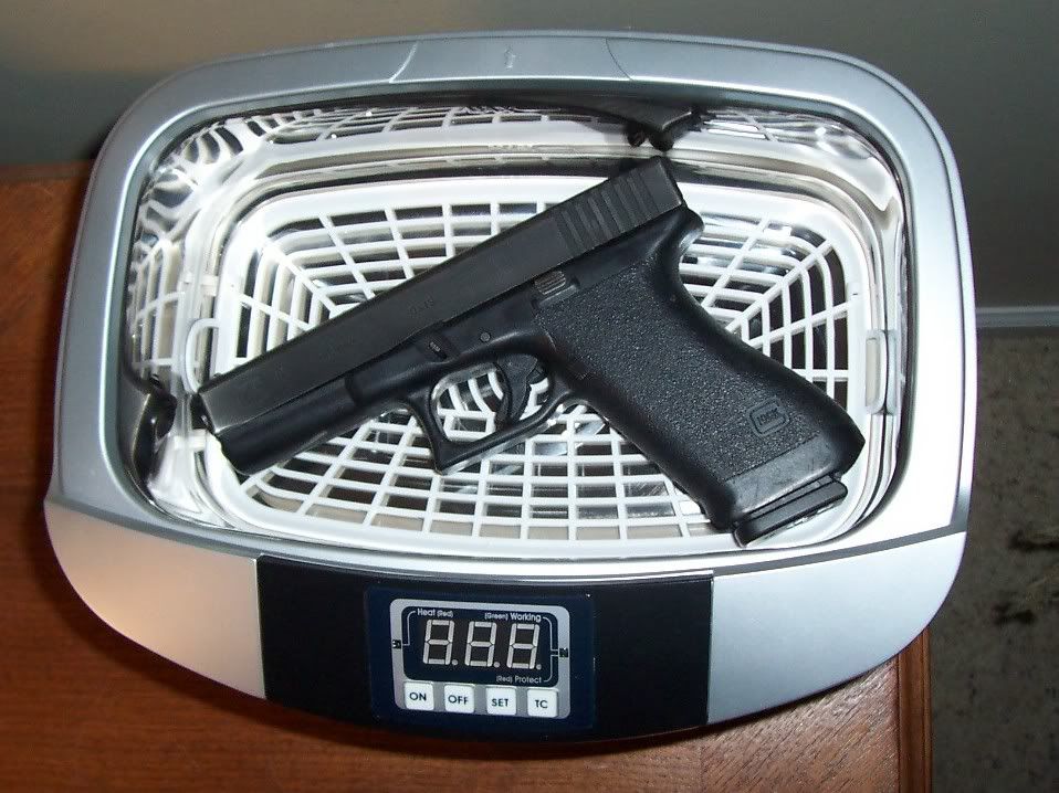

Go to Harbor Freight and pay 69.99 for one of the pictured ultrasound cleaners. This is exactly the same cleaner that Lyman sells for 139.00 and Cabelas for 109.00. I think mine cost 76.00 and change OTD and if you wait and get a 10% coupon you make get out cheaper than I did. Watch out for cleaning aluminum, pot metal guns, pearls or other soft "jewelry items." This is way cool. I stuck my eyeglasses in this thing and watched the crud bubble off. I stuck a guy's never cleaned 2nd Gen G17 in it, slide and parts first, frame and parts second and watched it get clean, probably the first time in its life.

Ultrasonic is excellent for cleaning most anything with lots of small spaces that are otherwise impossible to clean. As stated, be wary of cleaning anything soft. The ultrasonic works by cavitating (locally boiling) the water. The pressure wave created when the bubbles collapse knocks the crud off the surface. If the surface is soft and/or you leave it in for a long time, it'll erode metal. I doubt that one is strong enough to do much damage but you can put a coke can in the one we have at work and come back an hour later and it'll be gone except for the rolled edge around the top.

The cleaners we use in the military are bigger than this and use a few light solvents too, and we just have to take off the plastic stuff on our weapons, but the rest of the gun can be just put in.
I would "assume" just strip as far as you feel comfortable with and drop it in. For longer cleaning times, I would take the grips off if possible or just monitor Glocks and such with plastic frames, but anything steel or aluminum would be fine.

All of the above. You can put the whole gun in there and it'll clean out all the crevices, but you'll have to re-lube it after. Be sure the whole thing is submerged and swish it around to make sure the fluid fills all the passages.

Start with hot water, it works surprisingly well. You can add some alcohol to help cut grease and make stuff dry faster. Non-foaming soap (dishwasher detergent) may also help. I wouldn't use it for heavy degreasing. A pan, some paint thinner, and a toothbrush is good for that.

Most use Simple Green and water if cleaning non-aluminum. Also these seem to work better on "hard" dirt rather than greasy crud. I wish I hadn't just cleaned my AR bolt the day before I got this thing. That would have been interesting.
One of my friends put a Bryco slide in his US cleaner and it cracked . He did it on purpose. He also put an older Charter Arms in it and it took the hide right off that thing using some kind of citrus cleaner. He was using an even smaller US than the one I pictured. Pretty fascinating though. And some fun involved. Don't put that prized RG in that thing! Amazing how those little bubbles and right/wrong agent will attack certain things.
Bryco uses pot metal or Zamak (zinc alloy) in their slides. So I wouldn't put a Lorcin, Bryco, Raven Jennings, Phoenix, Jimenez, HiPoint, Walther P22, Sig Mosquito, Heritage, Austrian Arms ISSC M22 in one of these. I'm thinking the Walther P22 slide is Zamak and I think parts of the Mosquito are also. The slide on the M22 is certainly zinc alloy.

I use Comet multi surface spray cleaner, diluted with about 75% water 25 % comet. Cuts grease and crap real good. Not sure if it removes fouling but if you run a brush through the barrel and then slap it in there it works real well.
Also it gets hot enough to scald your fingers
Also don't stick your fingers in the unit while it's "on", feels like your fingers are on fire.
