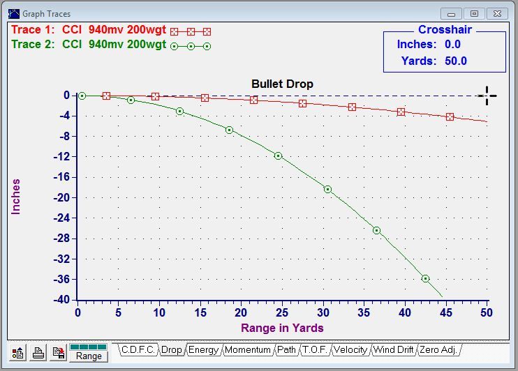

You can also confirm muzzle velocity with bullet drop. If you can boresight the pistol at 25 yards with a laser, then the drop will be a direct indication of muzzle velocity. This chart is a 200 grain CCI flat nose bullet at 940 fps (spec) and 300 fps. If you wanna try this, give me the ballistic coefficient of your cast bullets, and i can rerun it. It's gonna be close to this one anyway.
EDIT: Note that trace 2 is labeled 940 as well, but I edited the mv to 300
Edited by mikegideon
I was able to see the impacts at 50 yards, it wasn't 3+ feet low with either 1911's.
