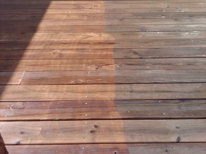

Difference one side pressure washed and one not.

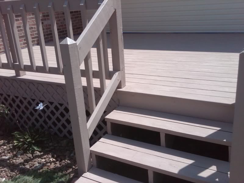

And after with my deck coat. Can make any color you want. Last for years. You can order similar products online and some concrete suppliers too.

Your deck coat looks like smooth coverage. How long between re-coatings do ya reckon?
I recall an experience of a friend years ago. He had a redwood deck, but I'd only go visit his house every year or whatever. One year the deck seemed in good shape. Next year I went over and he was tearing it down for rebuild, wood was completely rotten. In just a year.
Asked him what happened. He said it was looking a little rough so he painted it, then it rotted out quick. The guy had a couple of college degrees and ain't an idiot, but even smart people can do dumb stuff. I didn't know anything about carpentry and didn't ask him what kind of coating he used. Pretty sure he was at least smart enough not to use interior latex or whatever. Dunno if he used porch paint or some kind of opaque stain or whatever.
He figured that the coating had worked better to seal in moisture than to seal out moisture. Have you ever heard of anyone else painting redwood just to have it rot away? I assumed from his experience it is good to use some kind of coating that can breathe, anyway?
Usually if you leave the back side unpainted or stained the moisture can escape through the bottom. Actually the top of the deck itself has a texture you can't see that is actually a concrete product. Told it has a 5 year plus. I'm waiting to see. The rails and stuff are just coated with paint on this deck. they didn't want to spend enough for those as well.
