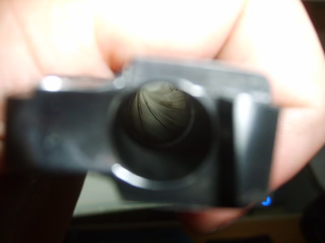

I recently bought a 24/7 OSS DS in 9mm. After a few problems I finally got everything resolved with this new pistol(It was missing the front sight). It took 2 weeks of waiting before I decided to just buy the replacement sight rather than wait any longer. While cleaning the pistol for the first time I noticed the bore is really rough. This was the initial cleaning before firing the first shot.
It has noticeable scratches on the lands and in the grooves. All the scratches have the same twist rate as the rifling but it is a bit dishearteneing to see how rough the bore really is. No other firearm I have ever owned or looked down the barrel of has been this rough. All others are smooth and you can tell if the bore is clean but not with this pistol.
So far I have shot about 200 rounds thru it using Federal 115 grain FMJ and seems OK as far as accuracy goes. It does seem as though it takes forever to get the bore clean compared to every other gun I have ever owned. Accuracy seems ok but this particular model supposedly has a match barrel but I can't tell.
Here are a few pictures:
This is a clean, as clean as I can get it, bore. I brushed it then mopped it for a few minutes for the pictures.
Is a bore like this normal for Taurus?
Also, with the rough bore I am worried it could cause leading issues with reloads and lead to pressure issues.
I bought this gun to replace the Glock I sold because I didn't like the Glock. I was planning on carrying this gun but now I am worried about other quality issues if they let a bore like this out of the factory.

I'll have to look at the barrel in my PT145, but I don't recall it looking like that. What you see are machining marks, looks like the broaching tool was a little dull. I can't think of a good way to smooth it out other than lots of bullets down the barrel. I wouldn't worry about pressure issues. The rougher surface may actually reduce the friction between the bullet and barrel slightly. Surfaces polished to a mirror sheen can be very sticky with regard to metal-to-metal contact, particularly when copper is involved.

I called Taurus and they said it is normal to have what appears to be scratches on the lands and grooves as long as thet go with the twist, which mine do. So at any rate I guess this is normal so I am a bit more relieved.
I have lapped plenty of barrels before, just not any pistol barrels. I will try Flitzing it first before I go crazy with any other methods.

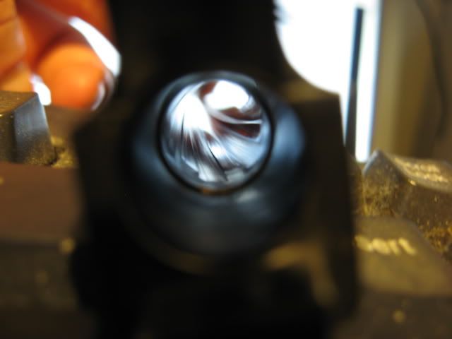

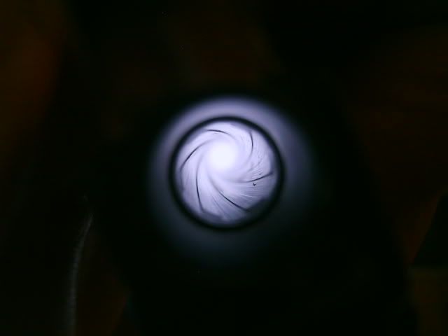

I put about 100 more down the tube including what is going to be my temporary carry ammo. After that I spent about an hour Flitzing the bore. It is a lot smoother and all the scratches on the lands are pretty much gone. The ones in the grooves are almost gone but still visible. I'll take pictures in a few days and post them as well.
This was on top of about 150 earlier today while I was practicing some drills. So now I have about 450 rounds thru the gun in two days.
What led me to Flitz the bore is I chrono'd the defense loads. I was only able to locate some Hornady FTX 115 grain ammo on the short notice I was needing it. They are supposed to be 1140 fps and in a 4 in Glock they still manage ~1100 fps yet in the 5.25" Taurus they only managed 1081 fps AVG. Because of this I suspect the rough bore might be causing some issues. When I get another chance I will chrono the same ammo thru the new and improved barrel to see what, if any, improvements it made. With the smoother bore I will be a lot more comfortable shooting cast now as well.

I just shot the same ammo, at the same distance, out of the same gun, during the similar conditions. It was a 5 shot average like before fire from the Taurus 24/7 with a 5.25" barrel. The ammunition that was fired was the same as before and out of the same box.
This time the rounds averaged 1106 FPS, not much of a gain but a 25 FPS is still a gain none the less. It equates to a little over a 2% increase. Kinetic energy difference is 298ft.lbs vs 312 ft.lbs.
I tried to get similar pictures of the bore for the before and after pictures. The light thru both barrels is roughly the same. I pointed the barrel in both pictures at my monitor with a white screen.

Before polishing the bore was dark and rough compared to the new bore which is light and shiny. It also cleans a lot easier. Before I would scrub for what seemed like an eternity and still not be clean. I just ran a mop down it a few times then patched it and it was clean within an easy 3 minutes.
I might try this on a few other barrels to see if see similar results.
