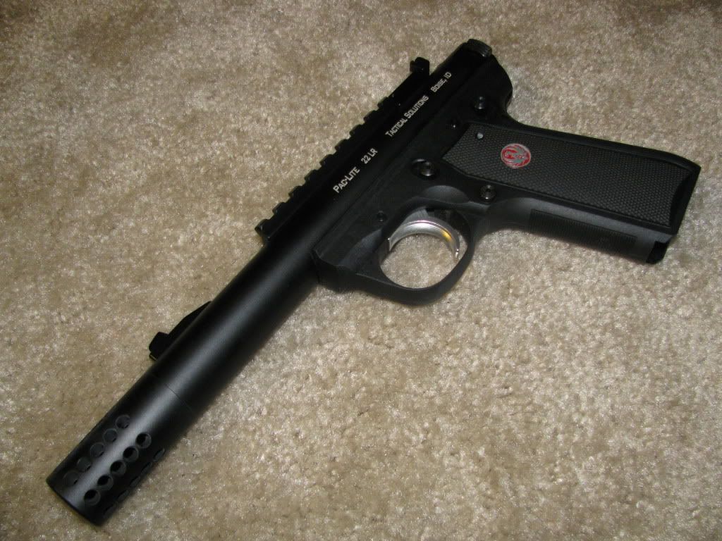

I dont have a scale at home, but my 22/45 is insanely light. Despite its weight there is very little recoil with the compensator on.
Mods:
pac lite upper
wolff reduced power trigger spring
wolff firing pin spring
volquartsen target sear
clark hammer busing (removes magazine disconnector)
to do:
install clark trigger
volquartsen exact extractor
red dot reflex sight

I have always thought the Paclite on a 22/45 frame would be fun to try. I was lucky in mine that I had a MKII hammer to replace the MKIII hammer that is cut to accomodate the mag disconnect mechanism, otherwise I would also have had to get a Clark bushing.

Hey Byrne, I like that PacLite 22/45 a whole very lot. :rock: Think you just spent some more of my money.
