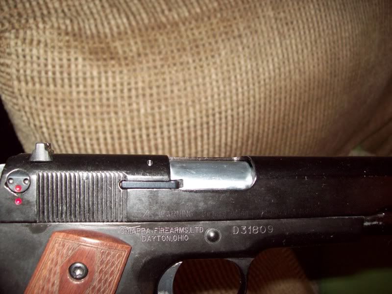

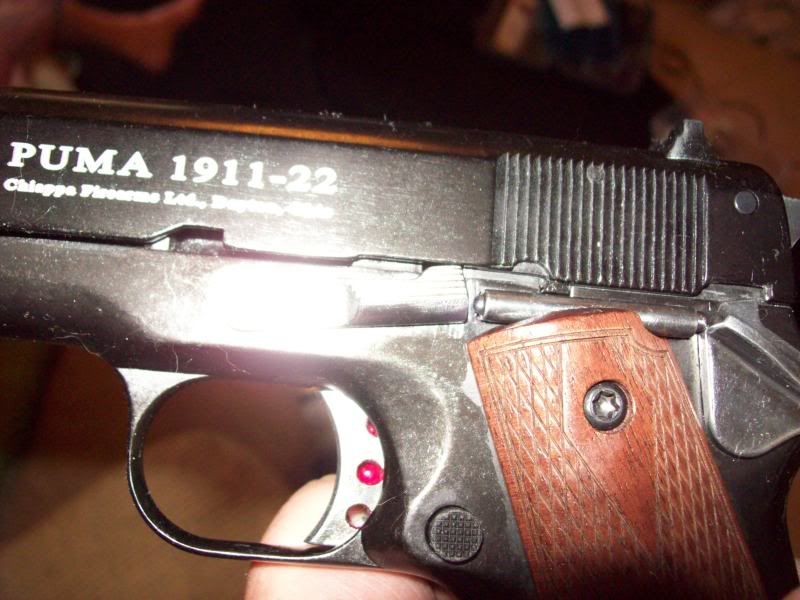

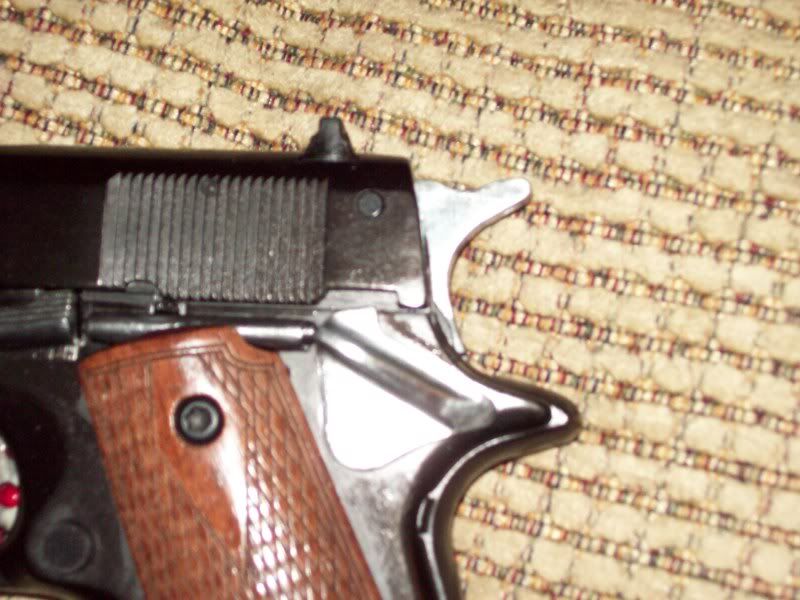

Below are some crap cell pics
If you don't wish to have a mirrored finish then just pay attention and stop buffing once you reach the desired level of polish

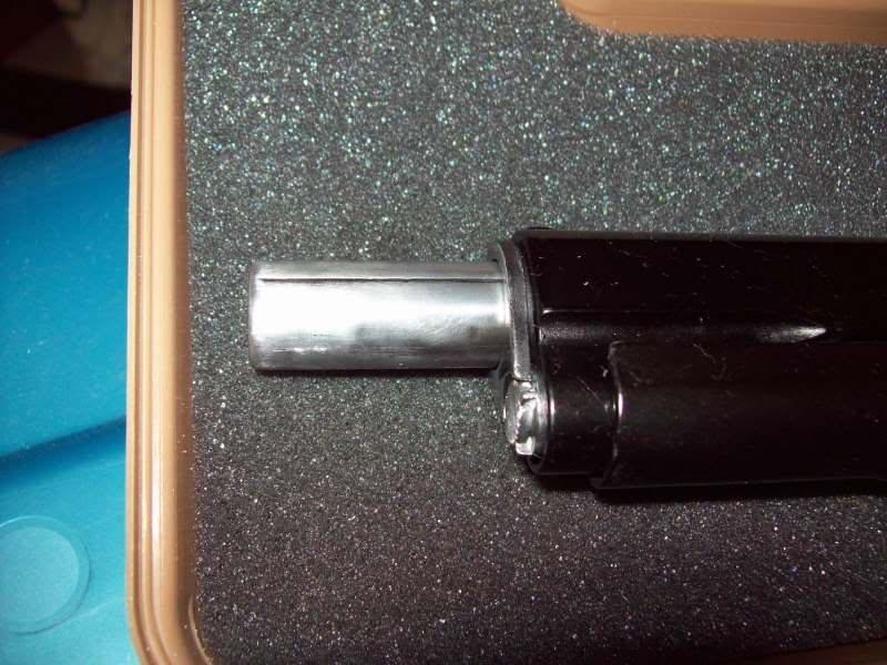

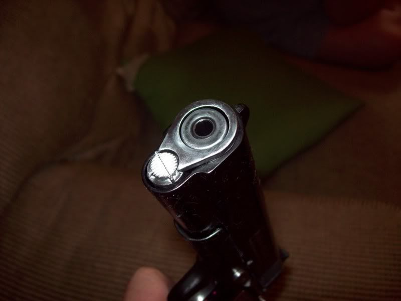

Found another larger pic of it
(just like rims, the mirror finish fades away when dirty)

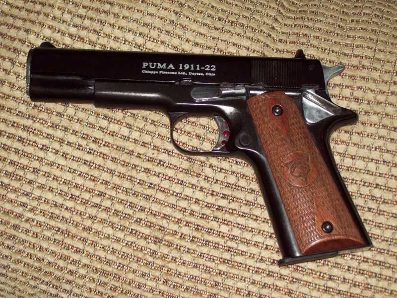

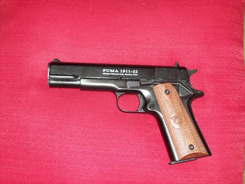

I got everything cleaned and lubed up. Here's some pics of the work I've done. I am happy with the polish job for now and when I get a chance I'm going to get some of thet Jewelers Rouge and really get it shined up.
The first one is the before pic.
