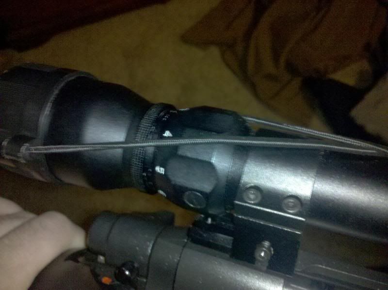

What kind of rings? That might be your problem. If the rings are not tight your scope might be moving.

Uh.. I don't know. But I do have a picture! :D

I"d blame the rings, then scope, have you let someone else shoot it to see if they could do any better since you are new to rifles, bye the way I have been shooting rifles over 15 years & 3 or 4 inch groups are my best, just never got good with one, thats why I stick to shotguns.
Guest coldblackwind
I'm thinking what you have is a cheap rifle, with a cheap scope, and cheap rings. May be the best you'll get out of it, or a better scope and rings might improve the situation. Most companys that include a scope and rings don't really give you anything all that great.

I prefer and recommend you get the Burris Signature Zee rings. They are the ones with the polymer shims. I have them on my Marlin XL7 which is also a low cost rifle, but with handloads is shooting Sub moa groups at 100 yards. If you need a better scope i can also recommend those too.
