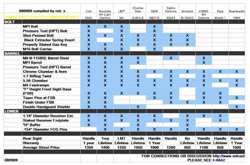

Here is the list that everyone has started to go by when buying complete firearms. I am not sure where RRA would be on the list or even if they would make the list. With that being said there are a lot of people out there who own and enjoy RRA rifles. Would I trust it with my life? I am not sure but it is better than nothing.

In addition to what the others have pointed out, RRA uses 4140 barrel steel instead of 4150CMV, no chrome lining in barrel and chamber (optional on some models), 6061 alloy for receiver extension instead of 7075, etc. I just don't see the attraction to RRA.

As for some of the things others have said. RRA barrel steel is just fine for anything short of sustained full auto fire. Straight pins are preffered ont he front sight base by many beacuse if you ever take off the front sight base it is a hell of a lot easier to get it back on and true to the reciever with straight pins. Tapper pins offer no real advantage.
The chart is all well and good if you want to compare everything with what Colt does. But when you start looking at things like a midlength gas system a lot of things on the chart becomes irrelavent. Such as the H-buffer this is needed on a Colt, however it is not needed and can be detrimintal to a midlength as well as some carbine length gas systems with a smaller gas port in the barrel than a colt. F marked front sight base agan is not needed on a midlength, not to mention some companies use the same height sight base without marking it with an F.

For $100 you can get an RRA to be every bit as reliable as a Colt. It will cost that mutch to put an RRA trigger in a Colt and you still don't get an accuracy guarantee. Milspec requirenments for colt are I believe 3 MOA.
