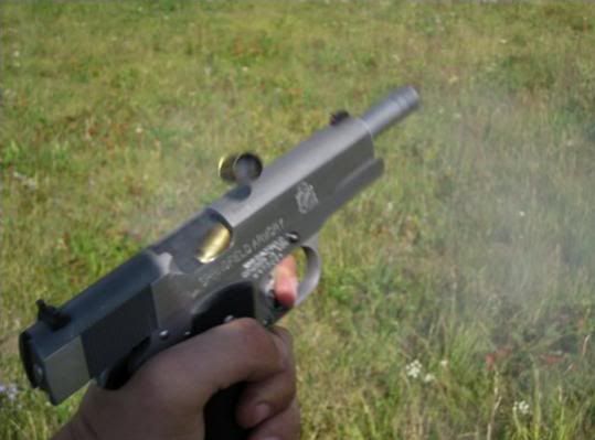

You never should lube 1911 mags. Clean them yes but never leave any oil on them. It can result in this malfunction caused by lubed mag and inertia.
Ok then, never knew that so thanks... Don't flame me but I've never really cared much about 1911's anyway...
No flaming...........just some info for whom ever it applies.
