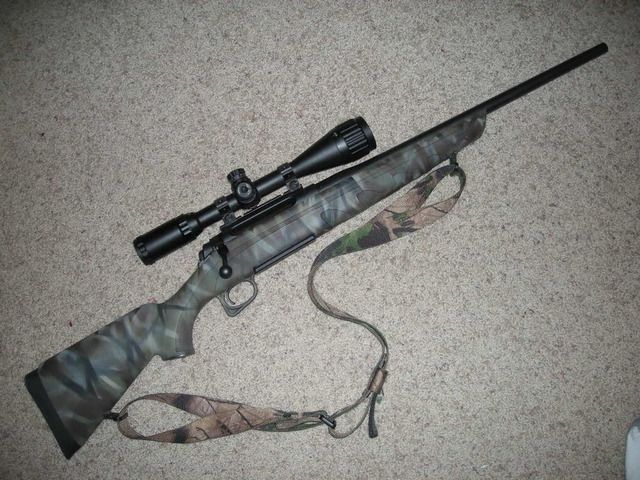

due to some request from a pic i put in another forum here's my DIY rattle can camo job
supplies: camo spray paint, green scotch bright pad, tape, rubbing alcohol, tin card board (shoe box works well see pic below) cut into random strips 1/8"-3/4" wide. wally world has a ultra flat krylon that comes in a few different colors (tan,green,brown,black)

strips
finished product
