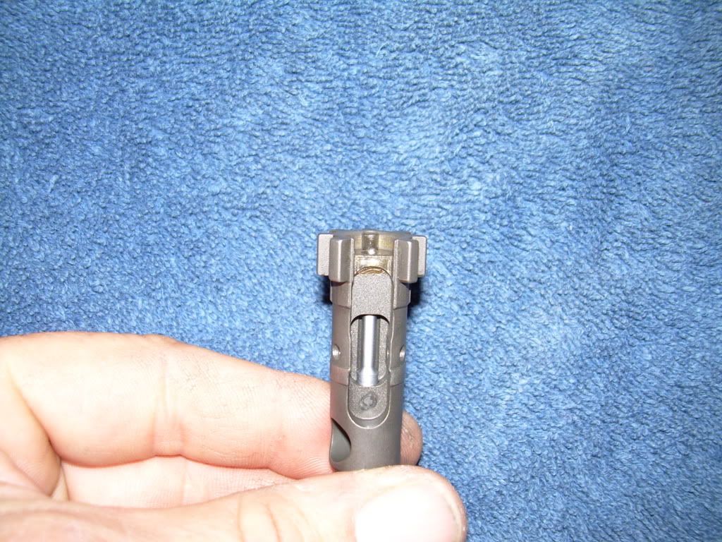

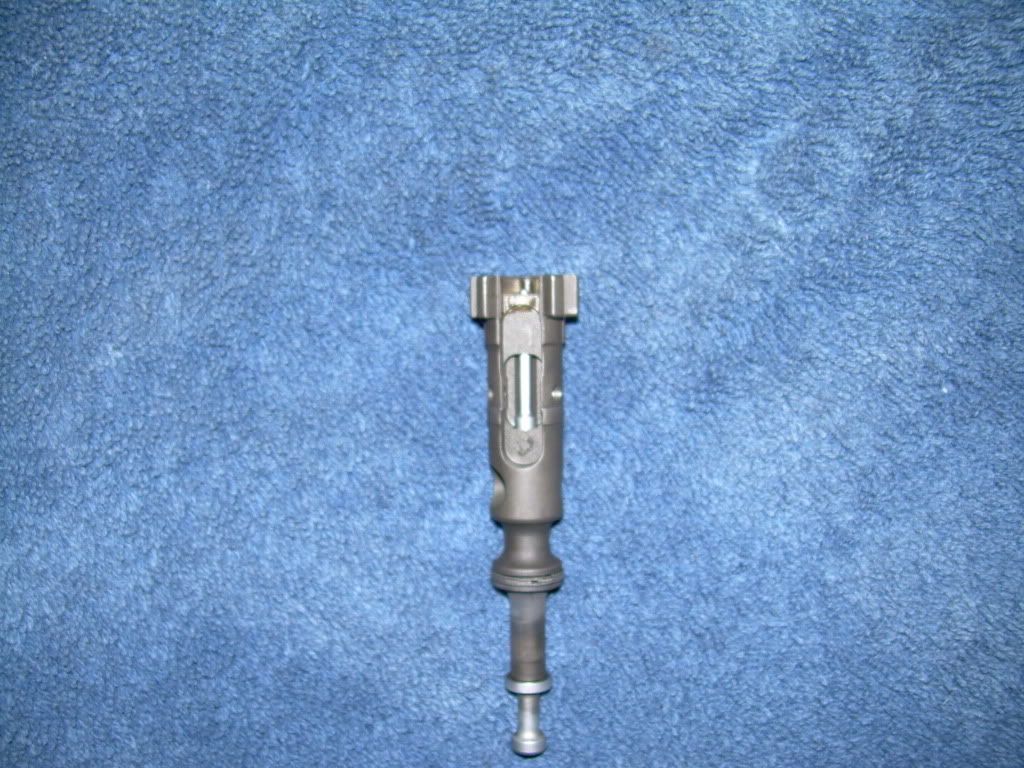

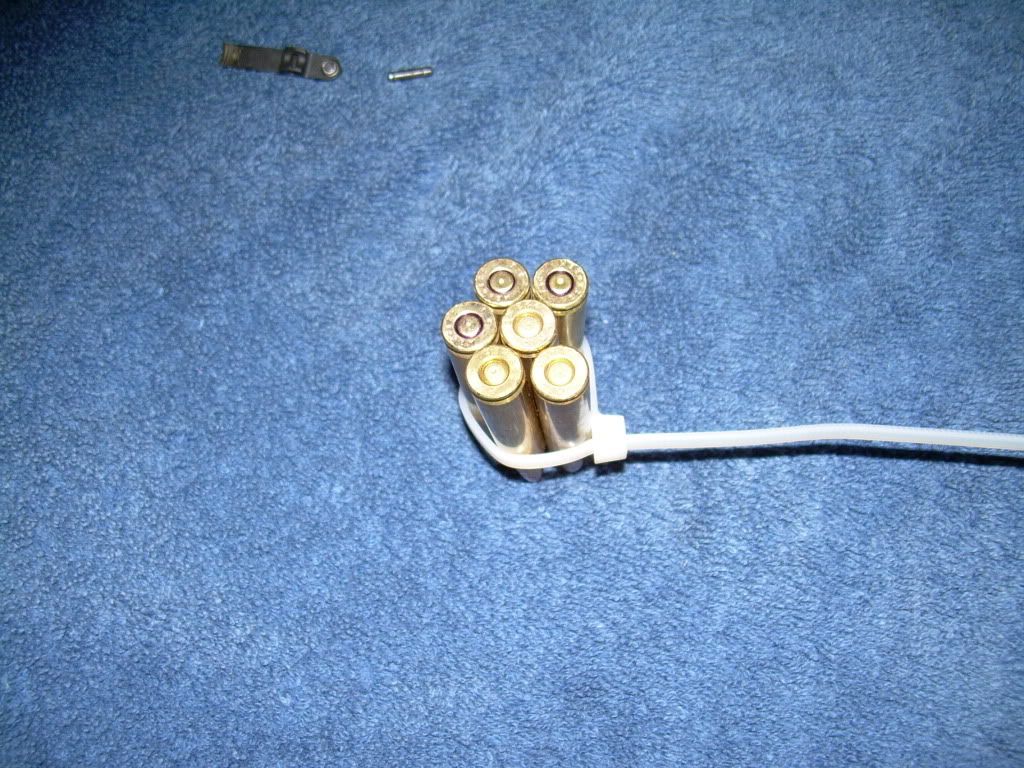

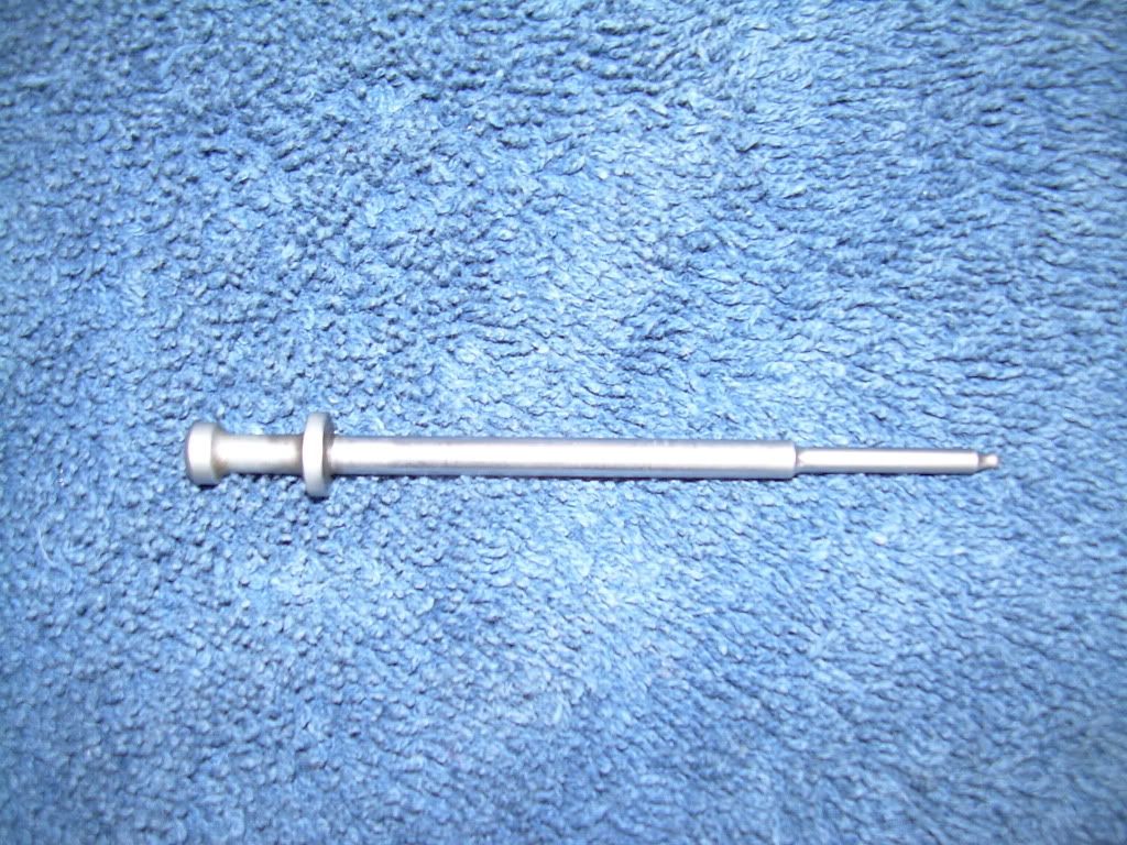

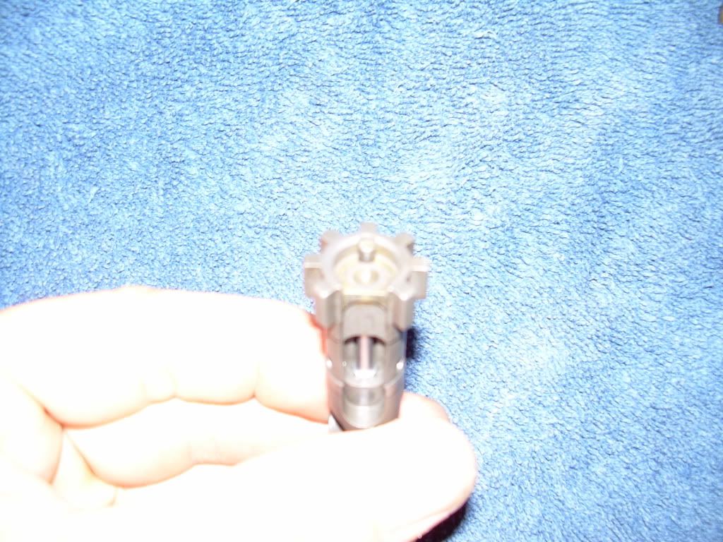

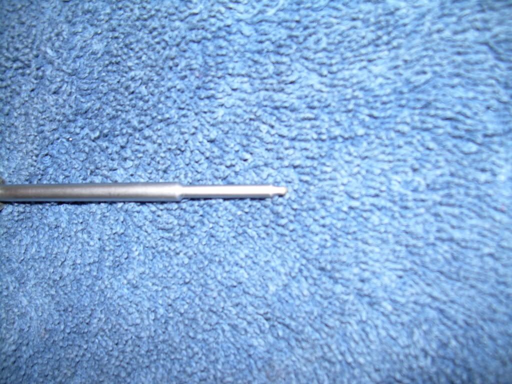

Hey all, so I got to shoot my new to me AR today and had some firing problems, now just so you all know I'm new to an AR so I've taken some pictures and hopefully someone can give me some advise, about 1/4 of my rounds wouldn't fire, the firing pin did strike the primer but IMO they didn't look like a good strike and I can post pictures of the unfired rounds if that would help, a few of the unfired rounds were put into my buddy's M&P AR and fired with no problems!!! I'm just guessing but maybe I need a new firing pin? Could it be wore out? My AR is a pre band DPMS lower with a DPMS upper. Here's some pictures and thanks for the help!!! COOP

It does appear the firing pin may be a bit short. Hard to tell from the picture. That would be a cheap easy fix attempt. If that didn't work, I would replace the hammer spring.

Seeing a mark on the primer from the firing pin is not much of an indication because the AR uses a floating bolt design. Ofter just racking the bolt will leave a small dent on the primer. Did you try different ammo and get the same results with the other ammo? If could be a primer problem.

Agree completely, but I'd also make sure the firing pin channel in the bolt isn't crudded up before doing ANYTHING else. Then I'd clean and lube the entire action, including the chamber, and try it again. Crud in sufficient quantities is an AR-killer, and they dooo like to be lubed once in a while.

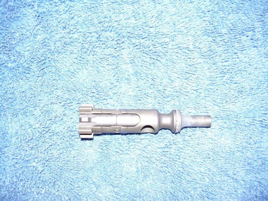

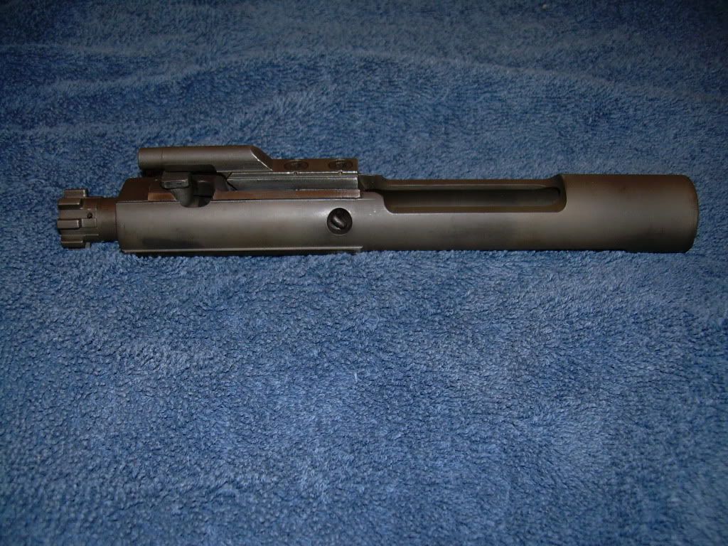

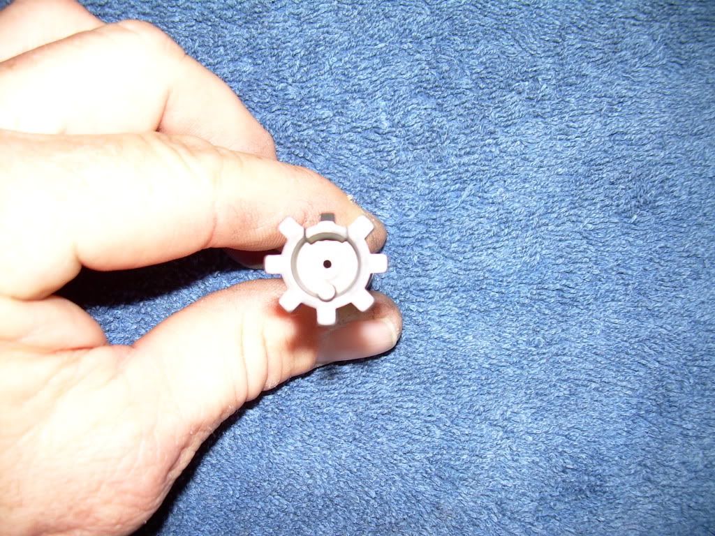

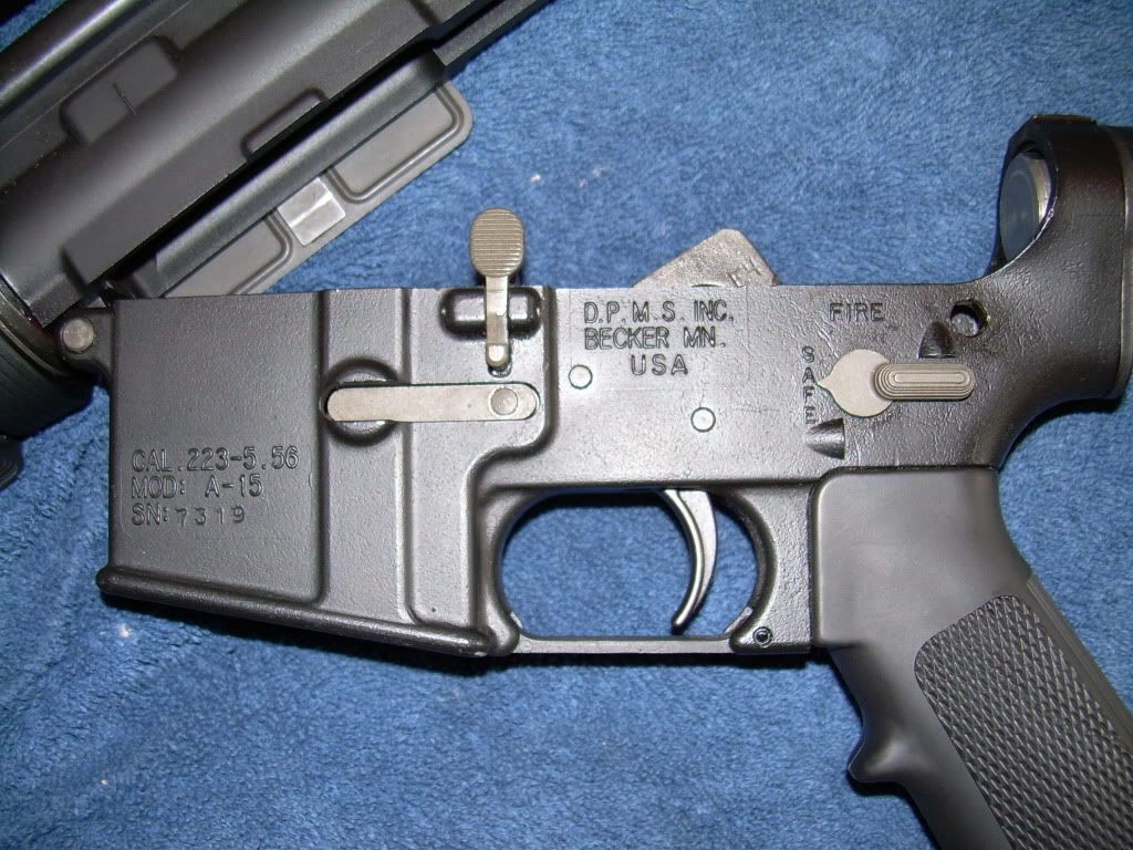

I dont think my buddy would let me swap a bunch of parts, his M&P is brand new and has about a thousand dollars in accessories, I think he loves his AR more than his wife.. LOL. Now my AR is pretty dry and I dont know all the lubrication points yet but will look for a manual and get it lubbed properly. Here is some more pictures and again thanks for the help.. COOP

The pics don't show any reason it shouldn't be shooting Coop so I would go with the big clean and lube as well. If you can, soak your bolt and carrier in CLP overnight and then get in there with pipe cleaners and brushes.
