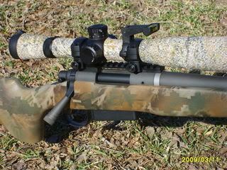

I recently graduated from Colorado school of trades for gunsmithing and these are some pics of some firearms I built while attending.

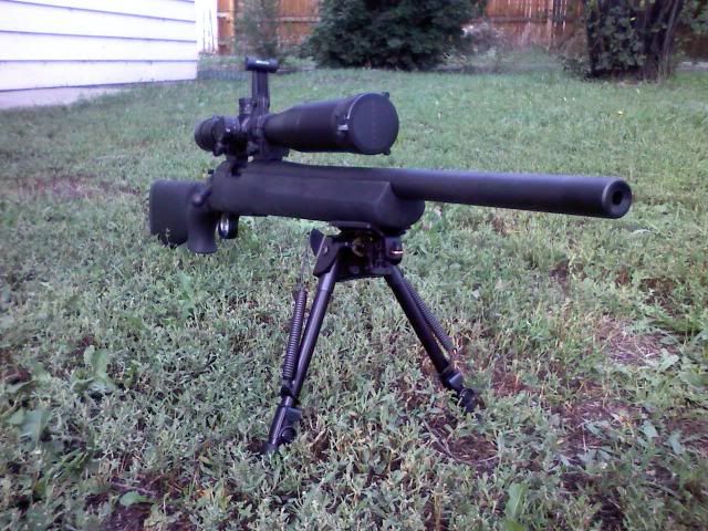

First up is a stock Remington 700 tacticool .308 win before.....

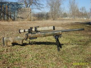

And now after....

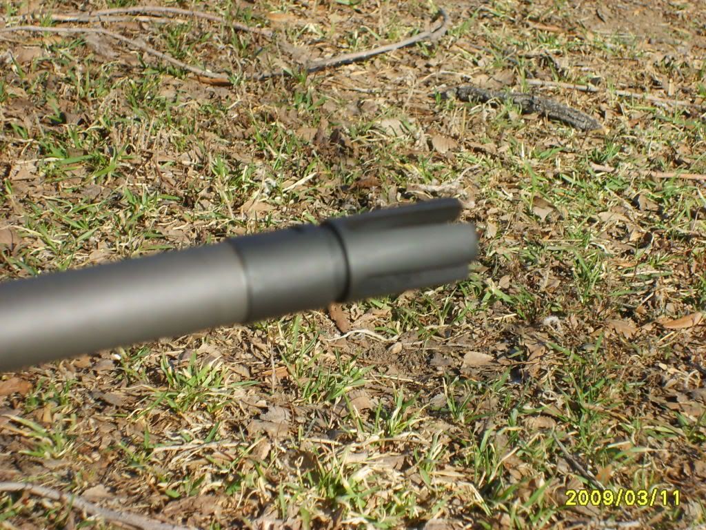

I kept the original barrel from factory because I saw no need to replace. I did thread the end for the flash hider (Vortex). Installed a Sako style extractor. Lapped lugs. Trued the action. Designed and built the oversized bolt knob. Installed an over sized recoil lug. Got a B&C stock and I duracoated this camo pattern. Bedded the recoil lug with dev-con. Parkerized the action/barrel, bolt knob. Blued the bolt body. Installed the accessories...scope,bipod,etc. And got this firearm out of a factory gun.
The proof is in the pudding...

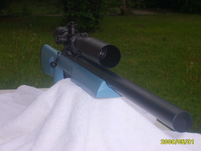

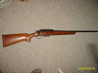

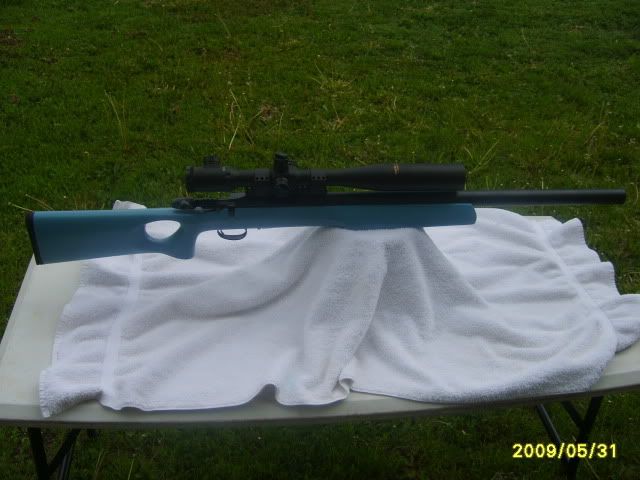

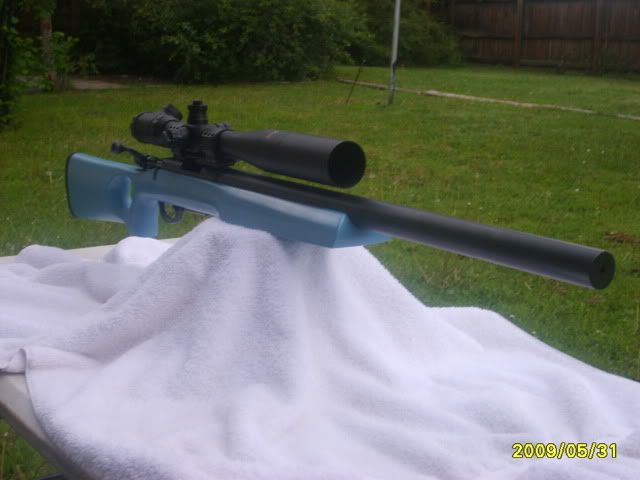

Another project was this Rem 788 in 22-250.....
before
And after.....
Installed an A&B barrel and rechambered it to 22-250 AI. Oversized recoil lug. Timney trigger because the factory one is horrible on this model rifle. MPI syn. thumbhole benchrest stock blank that I painted, inletted, bedded with dev-con. A Lot of work on this stock. Trued the receiver. On and on with this one. It is a punisher on the prairie dogs out here in CO where I'm currently at.

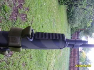

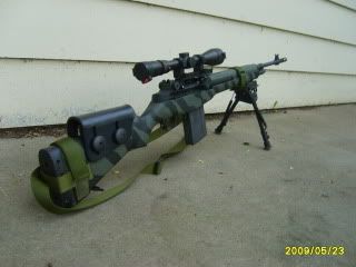

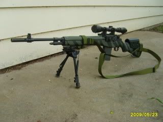

This S.Armory M1A I just painted,added a rail for the bi-pod,installed the cheek riser. Great gun!

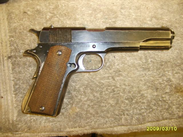

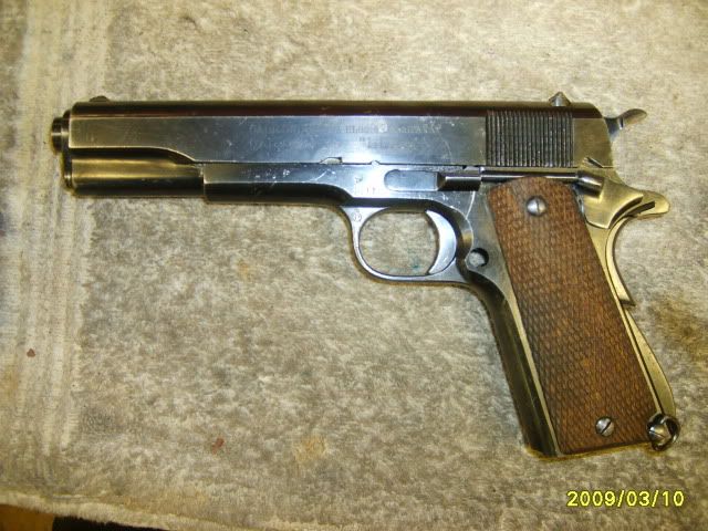

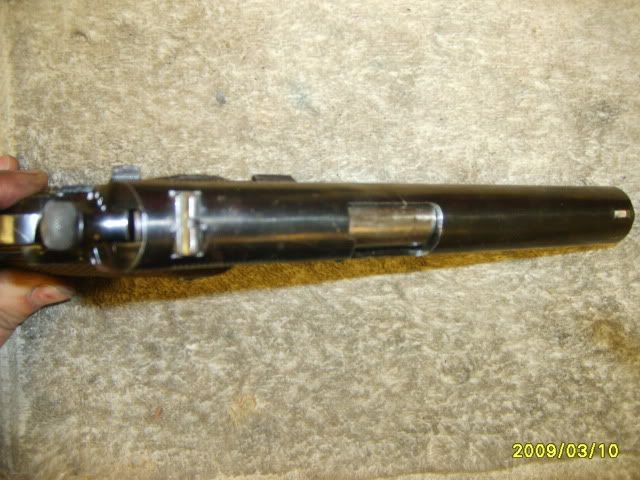

This is a Llama 1911 in 9mm that a friend wanted to test me with . He wanted to see what I could do.....
Before.....
Very ugly beat up thing! Not a great gun anyways but my friend liked it and I treated it accordingly.

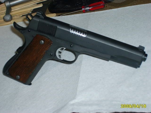

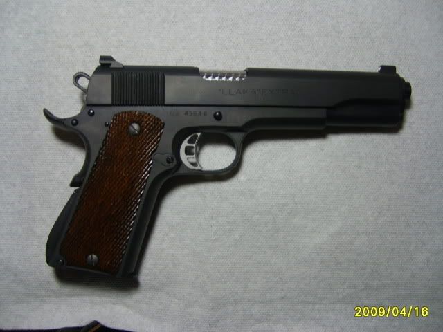

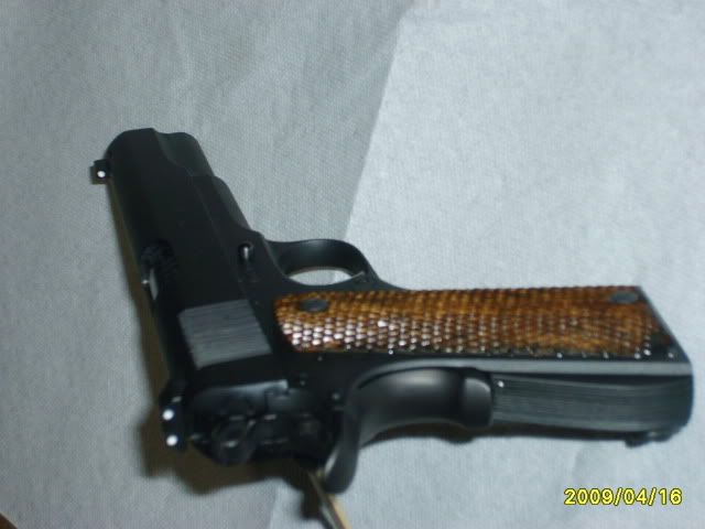

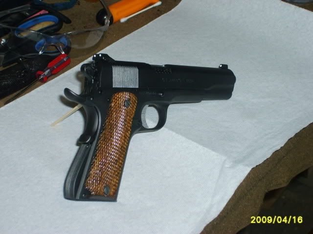

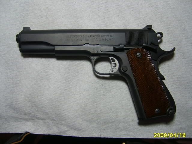

After.....
I put new sights in. Grip safety, thumb safety,trigger,hammer,jeweled the barrel hood, bead blast blued, re-checkered the grips and re-finished them. replaced all the internal components. This was not a super easy 1911 to work on due to it being a Llama and most parts don't just "drop in". Well most don't in a 1911 anyways but this gun especially.

Which rail did you use to mount the pod on the M1A?
GI stock or aftermarket?
Here is a picture of the one I went with. I just simply removed the front sling loop and installed this rail with sling loop. I did have to remove some material from the inside of the for-end to allow the op rod to move without contacting the screw heads.
I tried to find a link for you but it seems perhaps the company I bought it from isn't selling it anymore? Desert Warrior dot com is where I found it. After buying it I think I could have come up with a better idea on my own for less.
