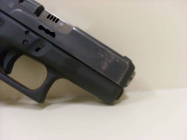

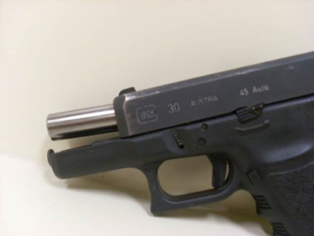

JHatmaker here on TGO was the other person to volunteer their firearm for a refinish. What surprised me was the fact that what Mr. Hatmaker provided was a pristine Glock 32 that had barely any wear on it at all. It takes cajones to offer up a like-new firearm for something like this.
Before I get into the photos, I do need to say this:
We often read and hear about how awesome Glock's Tenifer finish is. In fact, the durability of Tenifer has reached almost mythical status. Having now had one's slide media blasted, I have a profoundly deeper respect for just how true some of the hype about the factory Glock finish.
My compatriot who did the media blasting actually commented on how much more involved it was to remove just the black surface layer of the Glock finish. He stated that it took quite a bit more work than the other firearm pieces that he blasted for me, and that he had to run the air pressure to the maximum for their blasting cabinet. Even then, what resulted still had a lot of pigment left to it.
Clearly the Tenifer chemical-bath nitriding process really does penetrate deep into the metal and provides serious protection from within. I would wager that even with the black outer finish removed, the slide would have exhibited excellent corrosion resistance thanks to the Tenifer process.
Anyway, enough of that. Here are photos of the slide "in the white" as it were...
And here are photos of the slide after it was shot with Norrell's Stainless Moly Resin and thermally cured. As I stated in the thread regarding Daniel's SIG P6, the moly resin finish is not a paint and does not properly activate until it has been baked for a period of time at the appropriate temperature.
I am awaiting receipt of the nylon firing pin channel liner for this slide and will then reassemble it. I'm really pleased with the way the color and finish quality turned out, and entirely confident that even if the finish wears some over time, the Tenifer treated metal beneath will still provide superior corrosion resistance.
