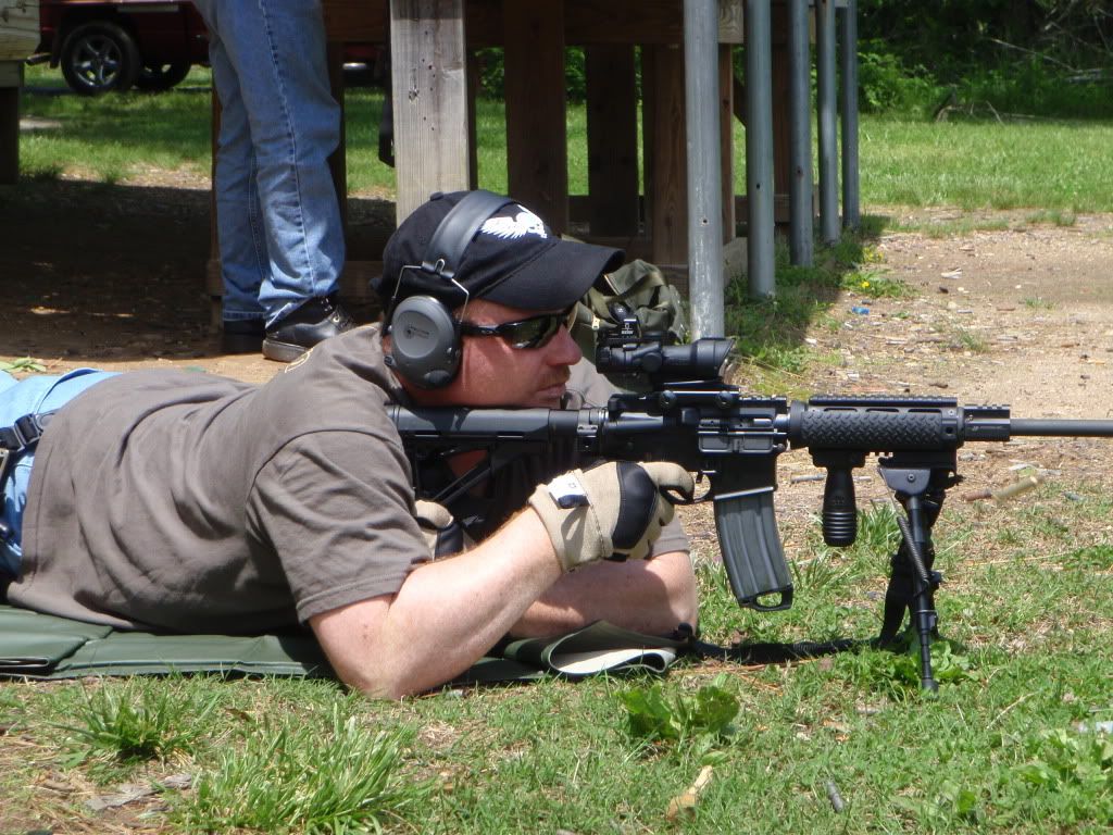

Well if you are looking for an ACOG then 7-800 depending on the model is more in the ball park. Dont pay any attention to the prices on the Trijicon web site they list mine at 1500 but I was able to find it for right about 1K.
It is hard to see in the pic but it has the doctor optic MRD on top.
