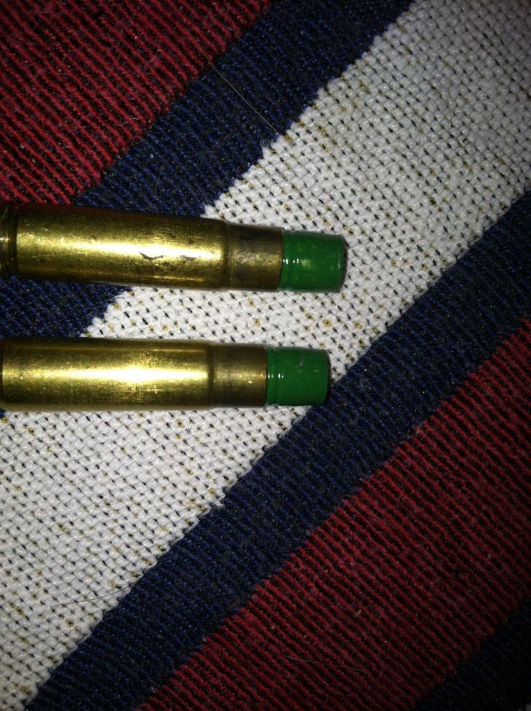

So here are pictures of my test loads.
58B15630-292F-413C-923C-95E4BF6B8F8B-189
There is plenty of room in the case for 8 grains of Lil'Gun and the front of the bullet. Yes, that is a powder coated Lee 230 grain cast bullet loaded backwards into the case. It chambers fine in my single shot so that is what I will be testing. I will also load some so they are engaging the throat.
So what say you?
If you're casting your own, why not modify the casting mold such that more of the bullet's mass is forward, but still be rounded enough to feed properly?
Poor aerodynamics would be the only downfall I can see with this. Since you are shooting at subsonic speeds, I assume that isn't a big concern. How would a properly sized hollow base wadcutter work in a rifle round? It seems like it would accomplish the same weight forward property you are wanting. Does anyone make a mold for a hollow base round nose? That might feed in a semi.

They did tumble but it was because of gas cutting. And the bullet probably never really got a good spin on it. There was tons of lead and powder coat left in the bore of two of the three guns I tried them in. Normally I have zero powder coating or leading but not when they are loaded backwards.
Another indicator that they were not sealing very well is my AR would not cycle 100% even though it has been 100% in several thousands rounds. As the gas cutting happened it reduced the diameter of the bullet and allowed gasses to slip by.
That makes sense in hindsight.    The gas is not slamming the flat backside of the round to expand it into the rifling and seal up like normal.   You may need a custom mold after all, or have to paper-jacket or something.
